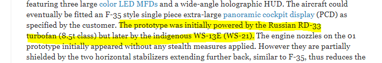

Any confirmation for this? Never heard that the uprated WS-13E might be designated WS-21?!!
WS21 is an UAV engine. So it may not be true
By the way ... any idea what type of engine under the Il-76LL could be? It looks slimmer than the D30-KP-2 and as such could be an engine for a fighter-sized type? ... maybe the WS-13E, WS-19??? I have no idea.
