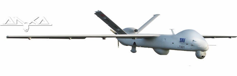

ANKA-S which has 150kg less fuselage weight
Bro. did you add weight gain from ASELSAN CATS- ASELFLIR 300T change to this '150 kg' ?.. Also how much weight SAR system will have ?..
And shortly... How much weight we gain in total ?...
With current dataes We have, It is quite difficult to calculate. Most probably, TAI will reveal all details When they inform sources about ANKA-B but;
Fuselage: 160kg weight (-)
CATS: 50kg weight (-)
Aselsan SAR: ~100kg (+)
SATCOM: `50-60kg (+)
Ok, thx...
Another thing... There will be SATCOM as i remember too but this fuselage of ANKA-S
Doesn't fit this ANKA-S design which has SATCOM...
Why so ?..
That's the design revealed, not the one we use in forums but When It is looked outside, Anka will look like more or less photoshoped one posted above so I don't care to use a photoshop image as real. o_O
No tried to say ANKA-S fuselage is not like it will have SATCOM but now i realize there is an empty space here and SATCOM will be there...
At the beginning i thought main fuselage's head will be shaped like these 2...
Now it's ok... When i look at first ANKA i see that there is not any emptiness like ANKA-S fuselage on it's head...
Thx...
