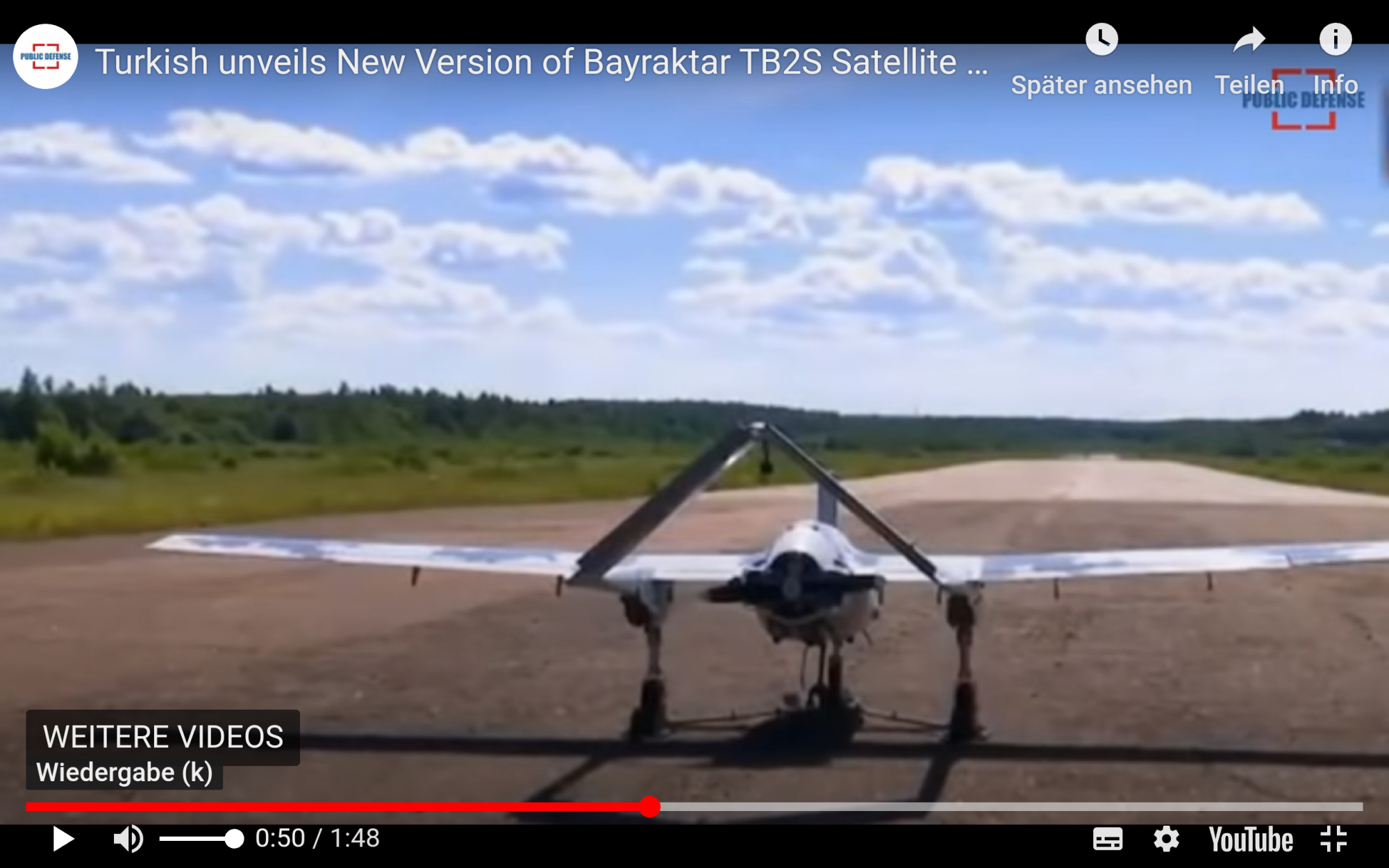

look at the video this could be the new tb 2 with a foldable landing gear. Engine seems to be different too could be pg 115.
