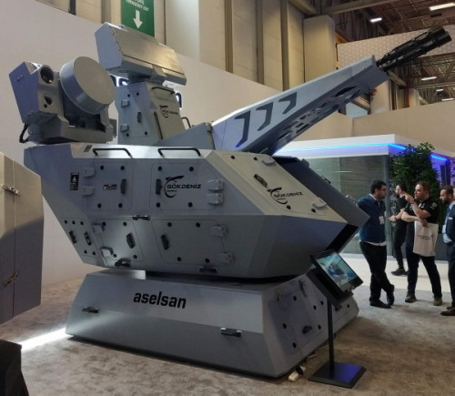

GOKDENIZ 35mm CIWS

Aselsan GÖKER, another 35mm Multi-Purpose Weapon System, capability demonstration shots completed in Konya.
GÖKER is a 35mm Single Barrel Weapon System designed to meet the up-to-date very low altitude air and ground defense needs, to be deployed in fixed facilities and border areas. Owing to usage of 35mm AIR BURST AMMUNITION (ATOM), GÖKER is highly efficient against to very low altitude air targets (Small-Mini UAVs, helicopters) and land targets.
GÖKER offers a comprehensive and cost effective system solution thanks to its independent electro-optic surveillance system, remote command capability, Linkless Ammunition Feeding Mechanism and flexible sensor integration infrastructure.
