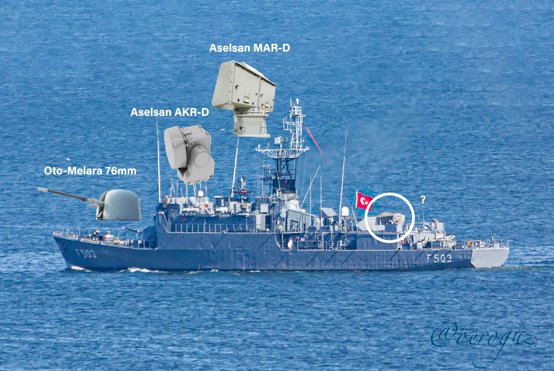

Covered part might contain torpedo launcher plus L-UMTAS + Cirit launcher...
Source
https://mavivatan.net/burak-sinifi-korvetler/
