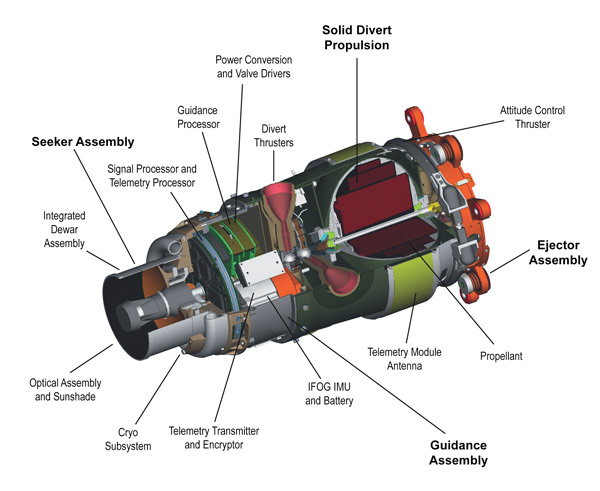

sorun bence bu ve bunun hedefe yönlendirilmesi =) Kinetic warhead
Turkey has just produced HISAR Systems, It shouldnt be big problem manage the rocket for ASELSAN or TAI.
May be formule of prolpellent or ground radar systems.
May be as you told controlling in harmony.
PAC-1 speed MACH3, PAC2-3 speed MACH4
s300-s400 speed MACH 6-8 :)
All rocket propellents are solid.
Old technology Nike Hercules have speed mach 3.8. So problem isnt speed.
