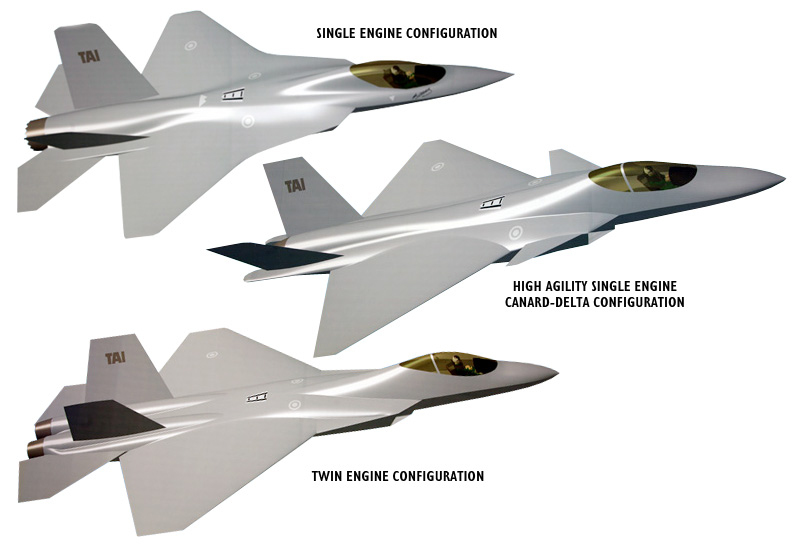

This Photo look like Generation 6 Concept, one step ahead than it planned !:D

it looks like it's MTOW will be around 27 tonnes
am truely believe we will make this tree design bec 3 differents model need air to air model air to ground and naval model for our future we will make this three =)
