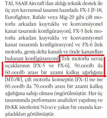

It is estimated MTOW (65000lbf) of FX-1 that dry weight of engine is also calculated inside of figure. There is not a certain specification table of prototypes so The taken figures serve to calculate more or less avarage numbers that is normal in that phase...
boss cebatlı how is it possible with one engine 50.000-60.000lb o_O this is lifting lb or thurst lb ?
The 50,000-60000-70000lb are the estimated max. take off weight of aircraft.
