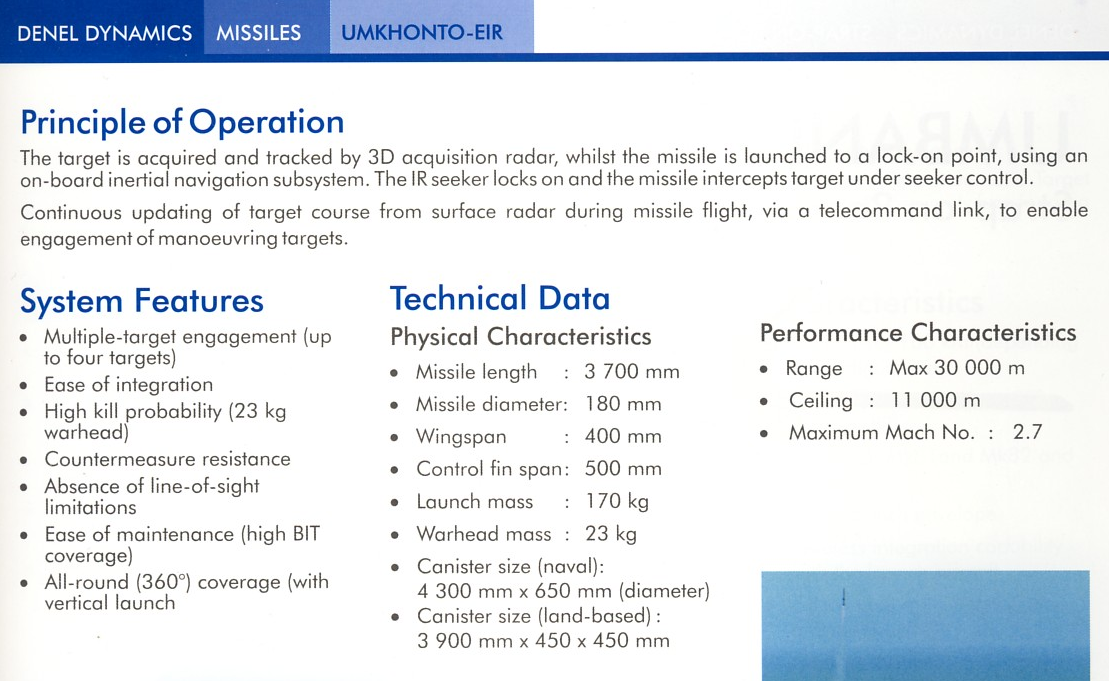

The uptake looks about the average man's height (see hatch). So, about 1.7 m extra atop of whatever is recessed in the hull. We don't know how much of the space under the hull was available to them, i.e., was it all or was it just a portion? I'd wager the minimum space needed in the hull is at least 2 m, otherwise, you're going to have trouble fitting any SAM type.
The base of the VLS will need some sort of foundation to control blowback and vibrations, and room for the initial exhaust. This Istanbul class has a draft of 4.05m
https://en.wikipedia.org/wiki/Istanbul-class_frigate
so a missile length of 3.7m which includes the raised VLS sounds reasonable. Which missiles are in this length class?
Umkhonto EIR, around 3.7 m

From this list, the Umkhonto and CAMM look like the most likely choices. But what about Harbah and/or Babar?

So Umkhonto EIR, CAMM, and some unknown indigenous missiles are the front runners with what we know today.
