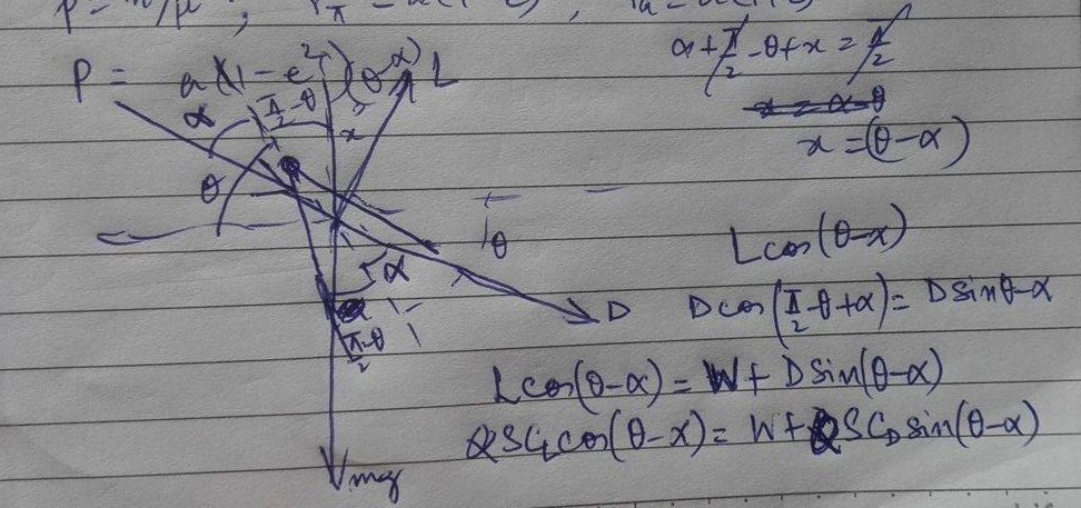

Here is a simplified Free body diagram of a ICBM RV,I have resolved forces in perpendicular direction,hence in perpendicular direction
QSCl*cos(Theta-alpha)=W+QSCd*sin(theta-alpha)---------------------------(1)
Kindly note that I've not included thrust, but it'll appear on the LHS of (1).
where Q is the dynamic pressure,
S=surface area
Cl=coefficient of lift=which again can be approximated by Clalpha*alpha
Cd=coefficient of drag= which again can be approximated by Cd0+k*Cl^2
theta=attittude angle or pitch angle
alpha=AoA
gamma=flight path angle(between velocity vector and the local horizontal)---not shown in the pic
Eqn 1 must be balanced all the time,but the missile is constantly accelerated till the burnout point meaning an ever increasing velocity and hence a varying dynamic pressure Q. For (1) to hold and we wish to keep theta at a certain value(as will become apparent later in my explanation),we would have to have some control over alpha. And alpha can be controlled by elevator deflection or actuating the jet vanes(--like shaheen and other older missiles),or by deflecting the nozzle using a servo-mechanism(in agni-4 or agni-5).

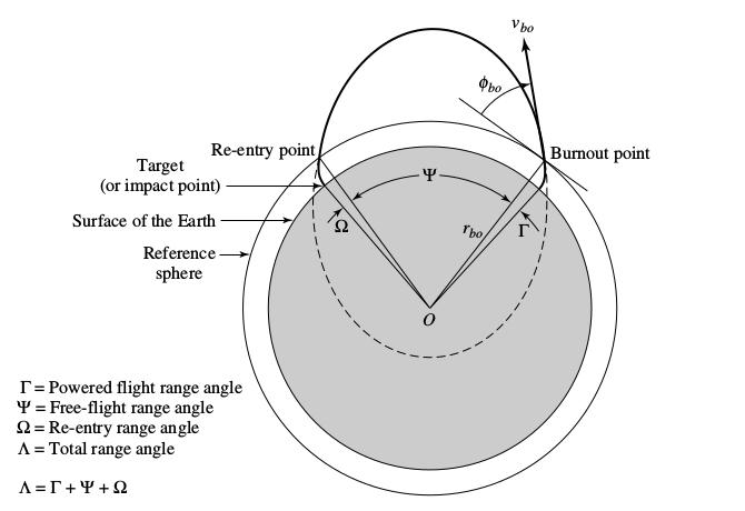

Once it has reached the burnout point,the missile should have a requisite velocity and escape angle denoted by fi(subscript bo) in fig-1.These two parameters are determined by the type of elliptic trajectory we want- again depends on mission profile- whether we want a depressed trajectory or a normal min-energy trajectory.These two parameters are so important that a minor deficiency can lead to huge errors later during the re-entry. Kindly note that fi(bo) is closely related to theta above.
The trajectory after burnout point till re-entry is elliptical with centre of earth being at one of the foci,hence normal elliptical equations apply(considering a TWO-BODY PROBLEM!,for three-body problem involving the effect of other bodies,more robust numerical solutions are required).
