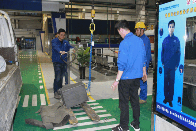

Would it have a significant impact on total weight of tank if all FY-2 is replaced by FY-4?
FY4 is nearly twice as heavy but offers better protection. Weight would increase but so would protection.
Each ERA in the pic is about 80 kg.
Yes of course protection would be better, that's obvious but my question was how much of an increase in weight would it be considering the tanks total weight of ~52 ton. Enough to seriously impact the power/weight ratio of the tank, or just a minor impact?
