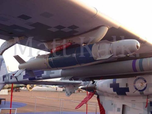

Interesting PGM from SA, Does it remind you of something?
do you see a similarity between Denel Targos & the Turkish SOM
SOM is unique from most ALCMs in that it's smaller and lighter. I hope Pakistan develops a similar type of ALCM ('Ra'ad Lite') for use via JF-17s as long-range conventional SOWs.
what’s wrong with simply getting the SOM off shelf?
