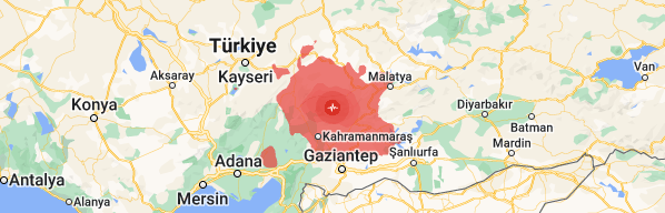

Magnitude 7.5 earthquake
Affected countries: Cyprus, Türkiye, Jordan, Lebanon, Syria, Iraq, Georgia, and Armenia
12 miles from Elbistan/Kahramanmaraş, Türkiye · Feb 6, 4:24 AM
This does not seem 7.5-7.8 ..it looks lot more than that. I have experinced 6.1 in my life.
