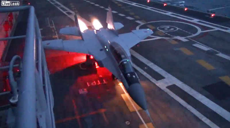

most beautiful footage of carrier mig29 tacking off with full afterburner
