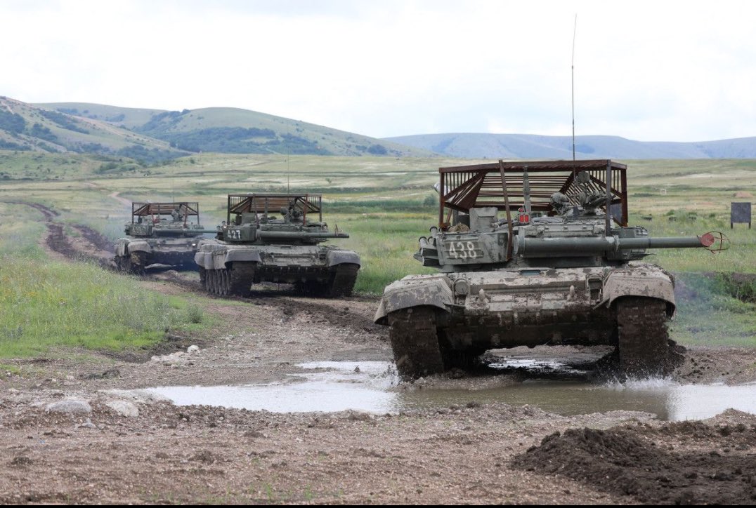

Cage armour on turrets of Russian tanks as anti-UCAV measure.
Despite the imprudent assertions that tanks have become redundant; tanks will hit back with improved turret protection especially from top attack munitions.
Moreover Active protection systems and ECM may turn the tables altogether.

I believe this was added as Top-Attack ATGM protection more than UCAV protection. I can also tell you it’s hilarious and will not stop either of those, the most it will do is obstruct vision and make it harder for anyone to get in and out of the tank, and also increase the tanks footprint, making it easier to spot. It really confuses me why this was done, it really doesn’t look like it will help much.

What a stupid idea, looks more like a jangla for Kabootars to land...
Though it may not be able to completely stop a Javelin used by Ukrainian forces it can considerably reduce its kill probability.
Ukrainians have also been using quadcopters woth rpg-3 warheads, that's why
It will still mission kill the tank be destroying most of the optics and the sensors on the roof. Maybe the crew will survive, you have to remember that the armor up top isn’t that thick anyways.
