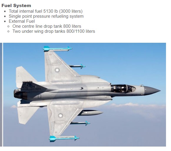

Thunder centerline tank is 800 litres not 800 kg. and the underwing 1100 litres not 1100 kg.
We know what the F16 CFT capacity is, so in abscence of an actual CFT for thunder, I assumed the same ratio to make my point.
no idea was just responding to some post regarding the increase in range with CFT's compared with underwing tanks
I took that info off of wikipedia...
I don't have a JF17 on hand and so internet searches are the next best thing...
https://en.m.wikipedia.org/wiki/CAC/PAC_JF-17_Thunder
There u can see the fuel tanks listed as 800 Kg or 1100 Kg...either can be used(on the underwing hardpoints).
...whereas the centerline fuel tank can only be 800 Kg.
Maybe it's a mistake on Wikipedia? For water it is roughly equivalent whether one uses Kg(unit of mass) or Litres(unit of volume)...bcuz the density roughly works out to be 1 Kg/L. So it could be that somebody swapped out the unit by mistake?
In any case using the density of jet fuel...the volume of the fuel can be calculated from the 800 Kg and the 1100 Kg number...
...unless these numbers are wrong to begin with.
no one keeps a jet fighter handy in their back yard to get the true specs, do use the internet but an authentic site.
https://www.pac.org.pk/Jf-17
That's even better if the current fuel tanks are of 800 L and 1100 L of capacity.
Let's just use the same unit for comparison...now that there's no need of using Kg and lbs...
Also using official sources this time...
http://www.defense-aerospace.com/ar...16-conformal-fuel-tanks-tested-(nov.-28).html
The source for that article above is Lockheed Martin.
It lists the F16 CFT's fuel capacity as 450 gallons(for both CFT combined). 450 gallons(unit of volume) = 1703.435 Litres
So one CFT can hold about 850 L
...if we assume JF17's CFT to be similarly sized as that of an F16's CFT(bcuz the two jets are close in dimensions)...then it seems that the CFTs can at least match 800 L fuel capacity of the underwing fuel tank.
