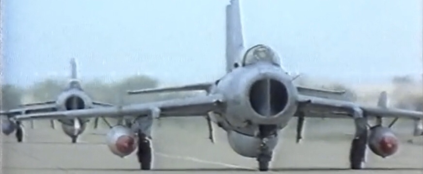

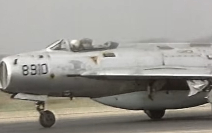

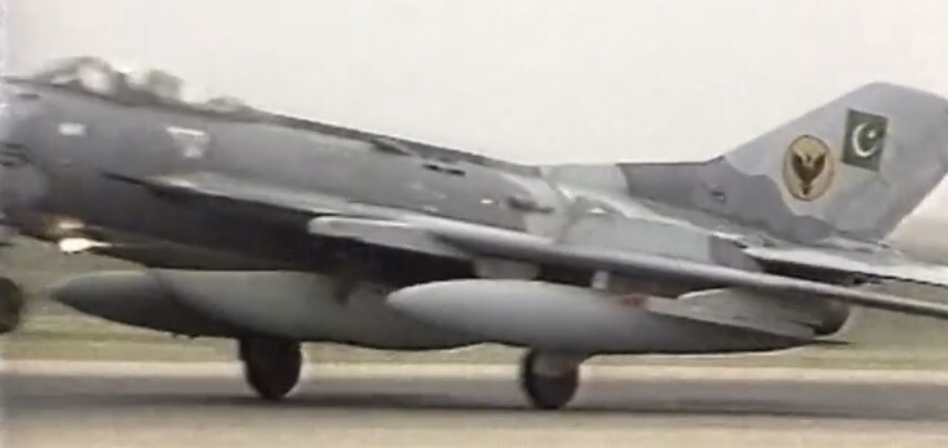

Gondola tanks were great invention and addition to the short legged F-6s but mounted on these aircrafts had it's drawbacks as it covered the main airbrake on the belly of the F-6.
Cft on f-6 ? Not sure why jf can get similar and the need for drop tanks will go away leading to ...
Even a single centerline 1200 liter will do or best option is two like most 4G planes
Quite surprised that i never noticed that, now that you’ve mentioned, i have made a good name for F-6, “TOAD”
It's first time I seen a F-6 configuration life this, was this Pakistan specific or other nations operating the F-6 had this also?
This was paf only mod done by paf but I am sure OEM must have been involved as well or consulted
F-6 mod for 1100 liters tanks was also I think paf specific vs standard 760 liters tanks
Ok. Thanks for info.
