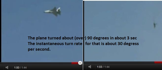

Would love to get a lecture on how ITR is calculated. I observed some JF-17 videos in the past and it could do the 1st 90 degrees in aprroximately 3 seconds. Unless I am totally wrong on my assumptions, I expected the ITR to be about 30.

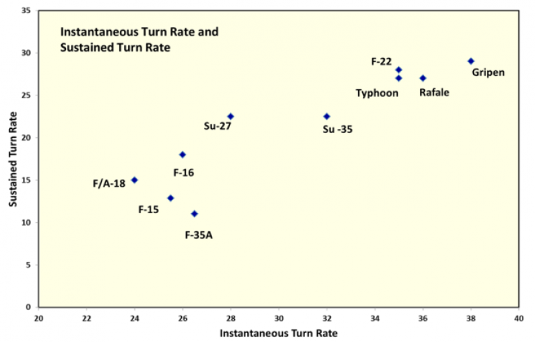

If I remember correctly, the graph below was presented by SAAB

By using this
video, I am estimating the Tiffy at 35 deg/sec and this us closely agreeing with the SAAB presentation:
This chart is not correct, I remember commenting on it in another thread, take it with a big pinch of salt.
About turn rate of JF-17 videos you mentioned, I remember a zuhahi show a few years back, demos were not too 'scripted' than and he took some freedom during demo. If you can find that zhuhai show video you can time 90,180 degree turns. Also he did 90 degree via rudder while in a turn, never done again. Will give you some idea about JF-17 capabilities and stability at high alpha.
F-16 demos lately by USAF have been much freer, you may find a couple of videos where it executes some swift consecutive 2-3 90 degree turns, will give you an idea of its ability to turn and conserve energy as well. Also I think you know that best turn rates are usually at medium altitude at transonic speeds for F-16/JF-17 like fighters.

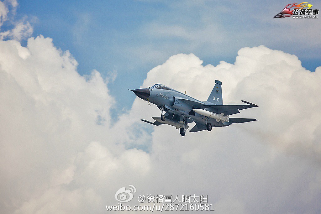

I wonder how long till we see the CM-400AKG in PAF or maybe if PN orders the JF-17, then in PN.
Also today at CAC together with the LRIP J-20A ....looks like a new colour scheme on an older JF-17-prototype or a new bird ?
Flying with CM-400AKG!! :)
