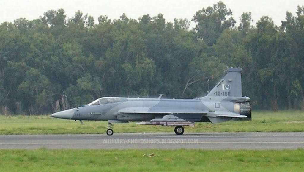

Wanted to ask If ever JF-17 comes with framelss Bubble canopy like of F-16/F22/J20 .If not why? what are challenged to it as it really gives an aeroplane quite a view+ pilot has 360 view .

There is a difference between a bubble canopy and frameless. A bubble canopy is one that literally sticks out of the iarcraft like a bubble to provide all round view. The F-86 had a bubble canopy.
A frameless canopy is one where the entire canopy is one big transparency. While this is great, it also means that the canopy has to be very thick and strong to support its own load and survive accidents such as bird strikes; this also means that it takes a lot more effort and finesse to form the canopy. A thicker canopy means extra weight on the aircraft, the F-16 canopy is one of the heaviest canopies for an aircraft in its class and costs more. By contrast, the sort of canopy the JF-17 has only needs the front portion to be thick to survive a bird hit ...while the rear of the canopy can be lighter and easier to form.
Nice explanation .Framless canopies do offer wider advantages then conventional canopies other wise with all tech/sensors in latest fighters like F22/J20 shoudnt have them .Considering Pak Fa it has again frame canopy any one care to explain whats the advantage and disadvantage .In terms of weight i guess couple of extra pounds wont hurt considering weight of frame is also subtracted in case of framless canopy
There are trade-offs involved here. First in the weight. Second is the cost. Third is the available power in case drag increases.
For all three reasons, what we have for now should suffice. Any resources available should go for improving sensor-based situational awareness, TWR, ECM, etc... Moreover Helmet Mounted Targeting Systems are a lot more important than a frameless canopy and would probably mean more in a dog fight. We have yet to implement HMTS solution in JF-17.
Frameless canopy may happen, but it is likely not a priority at this time.
