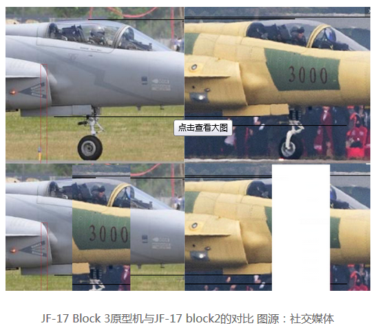

I don’t know why y’all ignoring this noticeable difference.
Behind Canopy, there is a slight elevation towards the end of spine in Block 3, that is, that it is not continuous flat unlike Block 2
This was done to provide pilot with a greater situational awareness during combat. This obstruction was also highlighted by some one in DCS.
Does the landing gears appear changed to you???
Its the Landing Gear Lights.
Not that its something to compare with, but the last series of the B737-NG's (Next Generation) had LED Lights replacing the oldskool lights on the Landing Gear & Wings. It was basically adopted prior to the introduction of the Max.
We have like 09 NG's with those type of Lighhts on our Aircrafts.

Other than the LED lights the landing gear looks slightly beefier as well.
This makes sense because with the increased load bearing capacity, the landing gear would need to be beefed up.

1. New air intake near the tail is a curious feature I don't have the expertise to understand
2. The aircraft looks deceptively similar but likely uses significantly different material. My guess.
3. Beefed up landing gear
4. Beefed up forward section (guess)
Thanks a lot and even if I don't agree on some of them like the thicker wingtips, different intake and larger radome, here's my layman's attempt:
Intake is clearly different
upload_2019-12-30_11-55-13-png.596744
