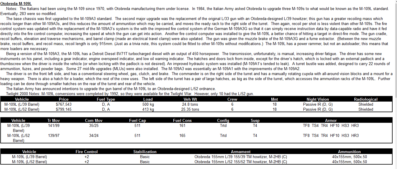

I am not sure but wisdom leads me to believe, Things on all of these supposed outdated guns can be updated. From Barrel to all forms of mechanical and electronic systems from possibly Turkey's indigenous systems they use on their own SP guns.
'If' that is the case then it is big bang for small buck.
They are updated twice during the lifetime in Italy.
http://www.army-guide.com/eng/product3729.html
Few things are missing in the above detail, that is:
1) These pieces were bought without Ammo, locally developed in Italy
2) Longer Barrel designed and installed in Italy

If all Italian M109L's are acquired, not only IABG/IMBG's but Infantry Division armoured regiments & Artillery Divisions can be equipped as well:
M109L:
1 + 1 + 1 regiments in 3x IABG (18 x 3 = 54)
1 + 1 regiments in 2x IABG under raising/planned (18 x 2 = 36)
1 battery each for 17x Infantry Division armoured regiments excl. 12 ID, FCNA & 34 LID (6 x 17 = 102)
2 Artillery Division (I Corps)
1x SP Heavy Regiment with M110A2 (exists?)
2x SP Medium Regiments with M109L (18 x 2 = 36)
21 Artillery Division (V Corps)
1x SP Heavy Regiment with M110A2 (confirmed)
Total = 264
