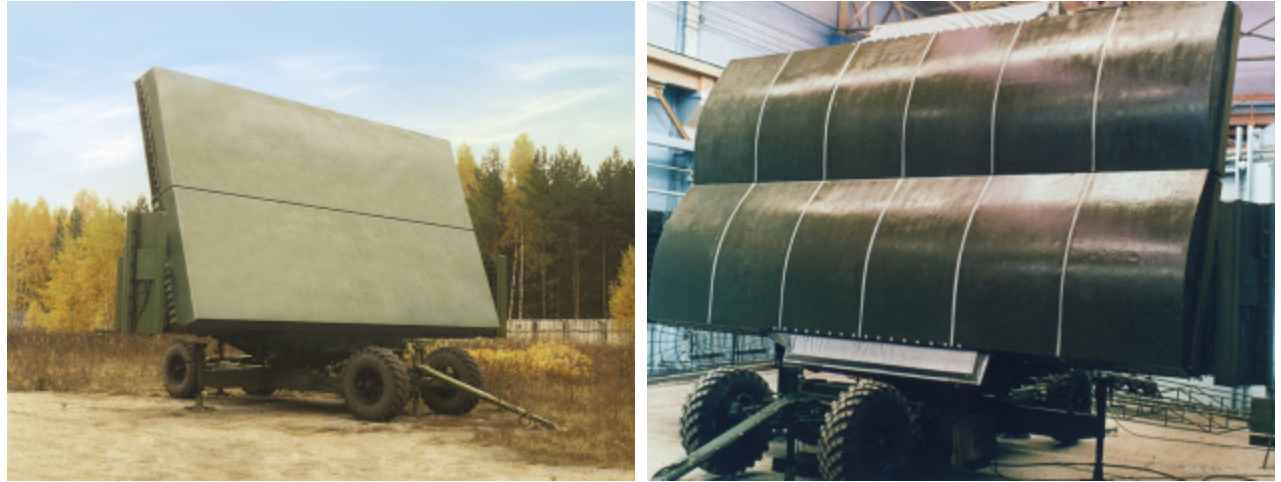

By the way, do we know what is the difference between these two versions of Gamma-DE?
They are basically the same as far as known. The S-300PMU2 is already fully compatible with the Gamma-DE, so no need for change.
The prototype/test versions appeared to have a curved radome,whereas the production version did not.
Interestingly the pic of the flat radome appears to have been produced from an altered curved radome pic.
looks pretty similar to this pic doesnt it?
