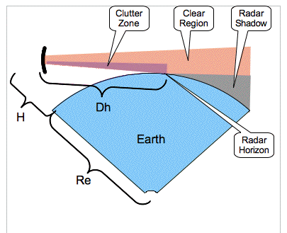

Do you understand this picture?? Please do tell me how having 4 bands will help your radars to detect a sea skimming target than a radar placed in a higher position above sea level.
Oh dude, these are two basic physics problems and you are not answering anything related to it.
Above the first blind speed, the Fregat clone on Type 054A cannot determine the velocity of the target and hence no firing solution for the SAM can be calculated.
No firing solution= no SAM fired.

Dude you keep on deflecting as you have no clue. Please google simple things like first blind speed and radar horizon.
Then we will talk.
Then we will talk.
Well, let me explain to you like this, I hope my English ability is enough. It is difficult to find low altitude targets, the curvature of the earth is indeed a reason, but it is not the most important reason, the most important reason is ground clutter. Most of the time, it is not that the radar cannot find the low altitude target, but because it is too close to the ground, the reflected clutter will hide the signal of the low altitude target. Any air defense radar has a "the lowest scanning height", of which C-band radar has the best "the lowest scanning height" and has the best effect on the accurate positioning of low altitude targets.
