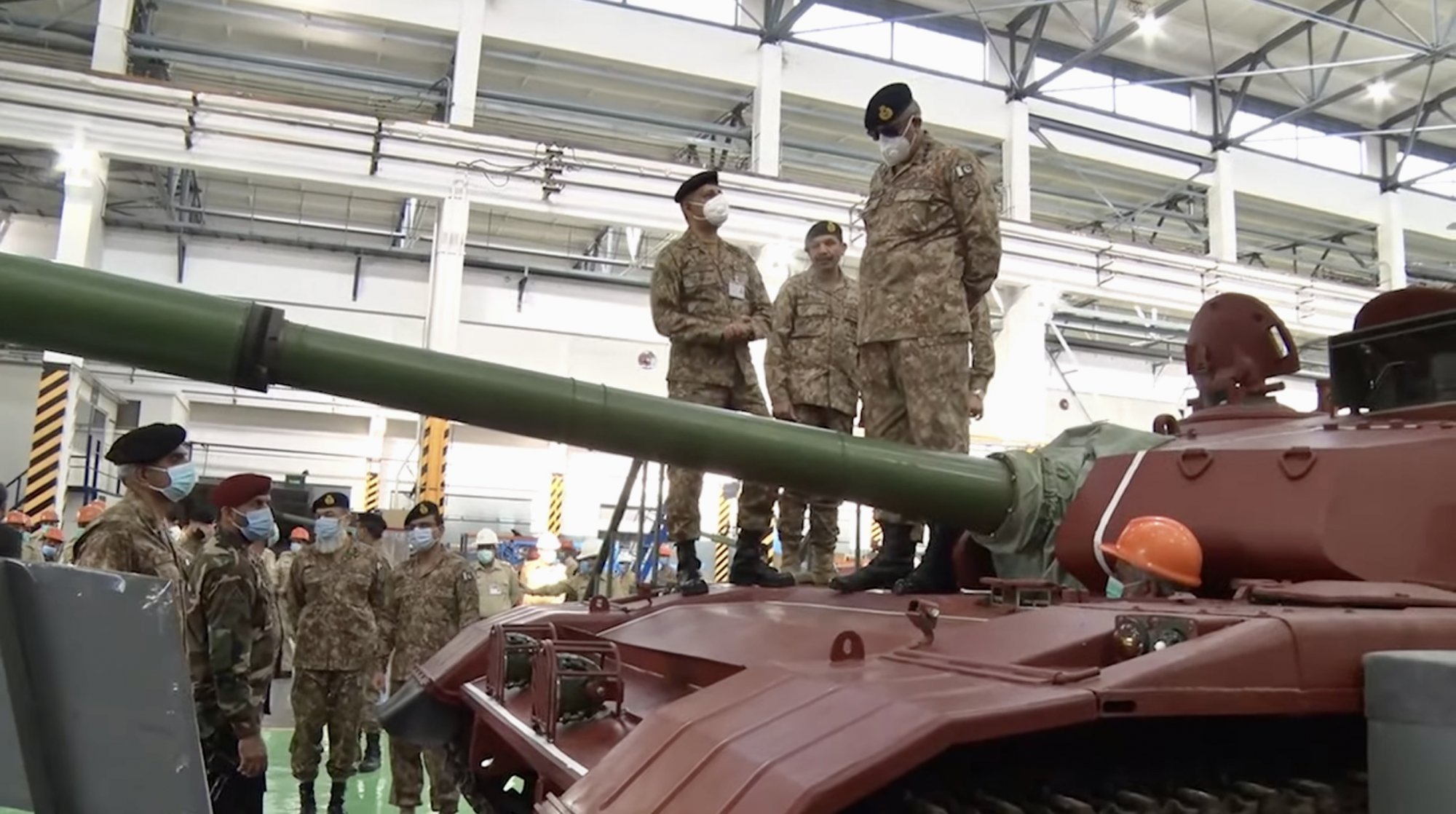

Today COAS visited heavy industries taxilla in this video by ISPR we can see armor of Al Khalid turret armor open and some information about Al- Zarrar. This is my first post so if its in the wrong category then sorry.

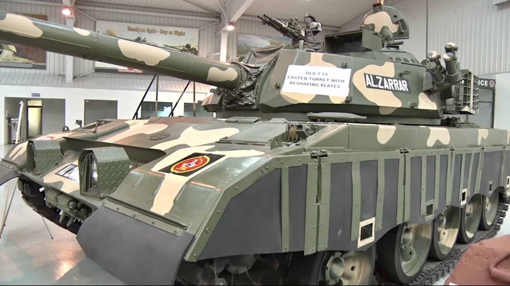

Also can anyone with good understanding about Tanks elaborate on images bellow?
View attachment 791787View attachment 791786
What dose it mean by old T-59 casted turret with reshaping plates? Dose this imply that Al zarrar is just old T-59 with some new metal plates attached to its turret?

As for AZ, the clip doesn’t show AZ still being under productionm the display tank is there 24/7, but maybe it does lend some credence to the fact that more were made, however it does show that UG is still getting upgrades and maybe more Upgrades than we initially thought.
And this confirms that the Al-Zarrar did in fact only have sheet metal reshaping plates over it’s turret and no actual armor increase (excluding ERA).

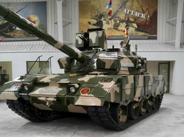

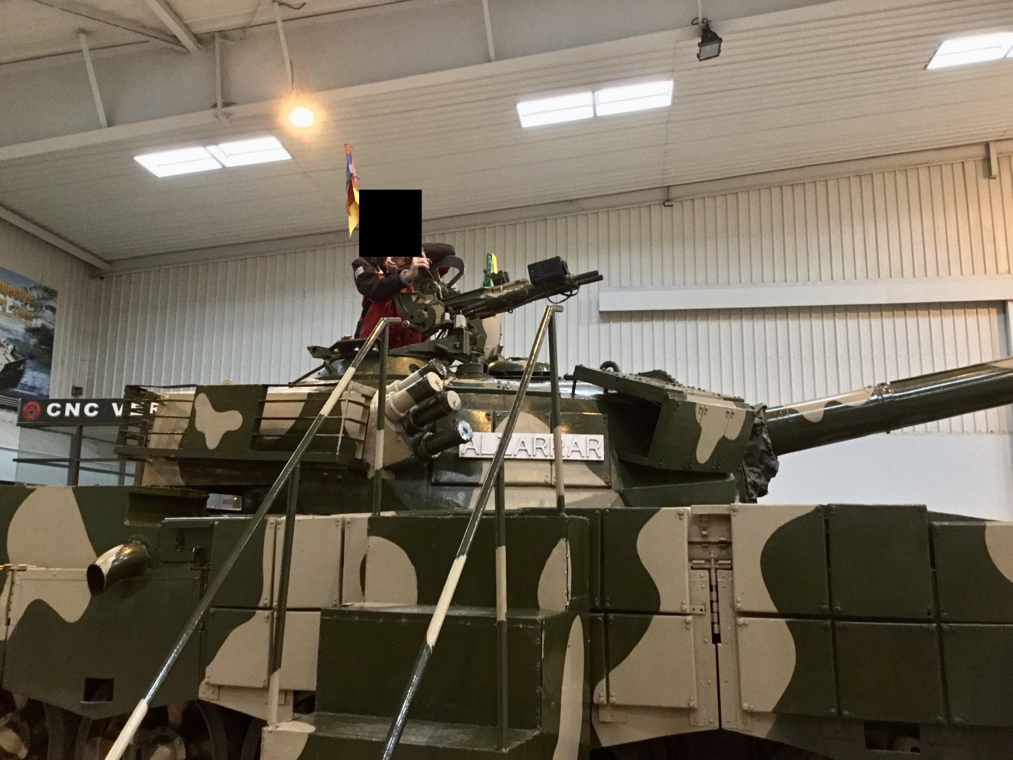

Later on HIT made a second version with composite Additions to the AZs turret, on top of which ERA can be added as well. I assume they parked both the old and the new one there but didn’t show the New one. However I do have some pictures of the improved ones I took at HIT (yet to see them in army use, but then again it’s just a bolt-on armor upgrade so it can be added at any time).
Keep in mind both versions have the hull armor upgrade which does include composites at the front.

Regardless, in the pictures I posted above, the second two are of an AZ with composite armor over the turret. So they did improve it, it’s likely a bolt on upgrade that can be attached at any time.

the pics of al zarrar are from the main display hall at HIT and this example of al zarrar has been standing there for as long as I remember.
al zarrar program was discontinued some time back.

It means the tank doesn’t have any additional armor on turret, just thin steel reshaping plates to attach ERA over, however as seen in the pictures I posted, the AZs they made later do have some sort of added protection at the front of the turret, seems to be composite.
Anything that know a thing or two about tanks would testify that any modern ATGM would pass through these relics like hot knife through butter
Plus Reshaping a turret with metal plates is shabby to say the least
not to mention that majority of Al Khalids & Al Zarrars roll without any ERA cover what so ever
those that do cover only the front of the turret where by leaving the side which makes for a larger target absolutely vulnerable
HIT is an incompetent company churning out death traps for our Troops without any consideration for R&D and study of the modern ATGM that are out there
We certainly arent gonna be pitching these tanks against militants armed with RPGs at best but against IA with far superior Firepower
