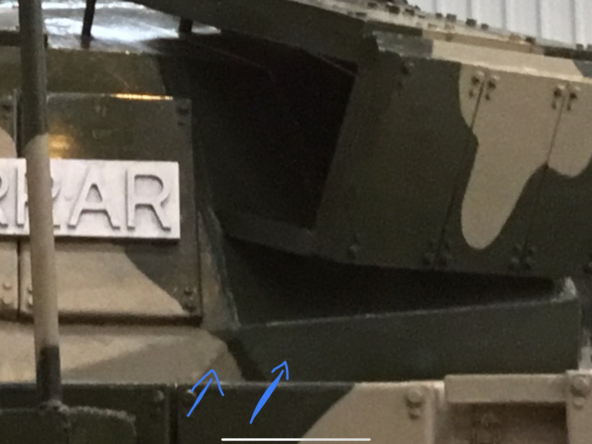

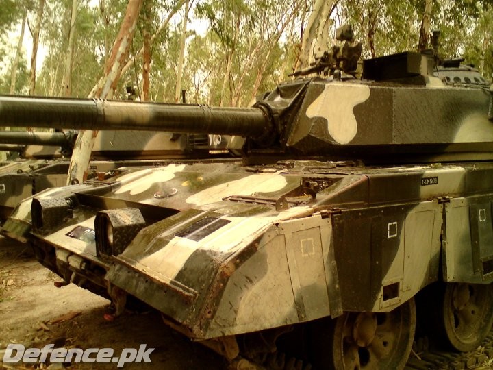

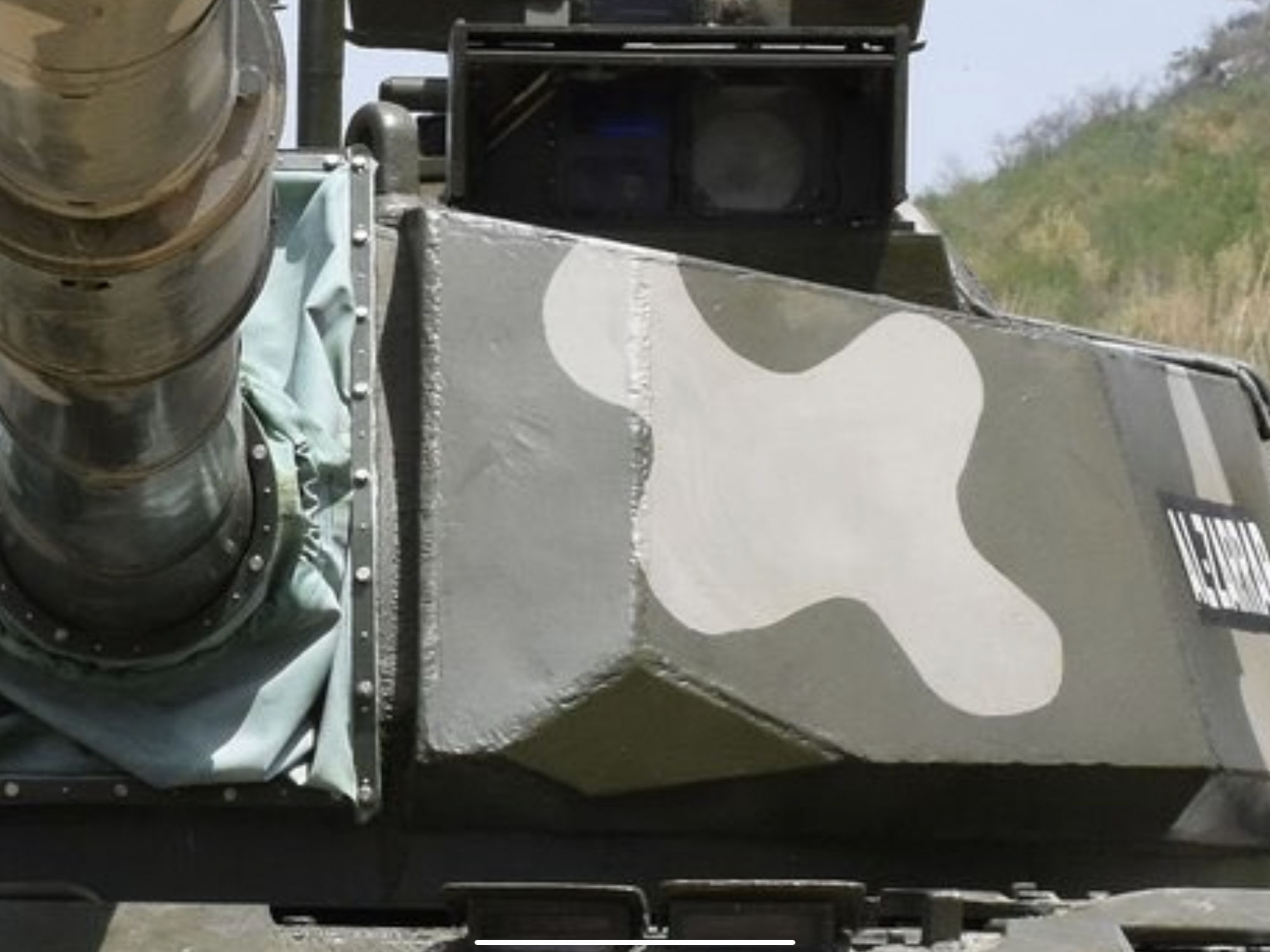

The increase in weight was due to the addition of composite and HHS plates on the hull, the addition of the larger engine, larger gun and it’s breech, the semi-automatic loading system, the upgraded suspension, new stabilizers and FCS etc.
It is true that in the original AZs no extra armor was added to the turret apart from the ERA, the steel reshaping plates on top of the normal type 59 turret were just to give a good surface to mount ERA on. Going off pictures and my personal measurements at HIT, they are very thin. The hull however did get armor upgrades as I mentioned above.
But as I just mentioned a few posts back, HIT did later produce AZs with extra armor on the turret as well, it seems to be some form of composite going by the texture. I’ve put some photos down below to show it. One set of photos is from an AZ without the turret add on (only reshaping plates), other is with the turret add on (some sort of composite armor)View attachment 792048View attachment 792049View attachment 792050View attachment 792051View attachment 792052View attachment 792053
I know the second version of AZ, but I was only talking about first version which did not receive ERA upgrades, the additional reshaping plates over the cast turret of T-59 are not commercial steel but HHS ...
I know the second version of AZ, but I was only talking about first version which did receive ERA upgrades, the additional reshaping plates over the cast turret of T-59 are not commercial steel but HHS ...
Both versions of AZ have ERA. One has Reshaping plates + ERA (they’re the same version, it’s just that ERA isn’t always mounted during peacetime), the other version is Reshaping plates + add on armor + ERA.

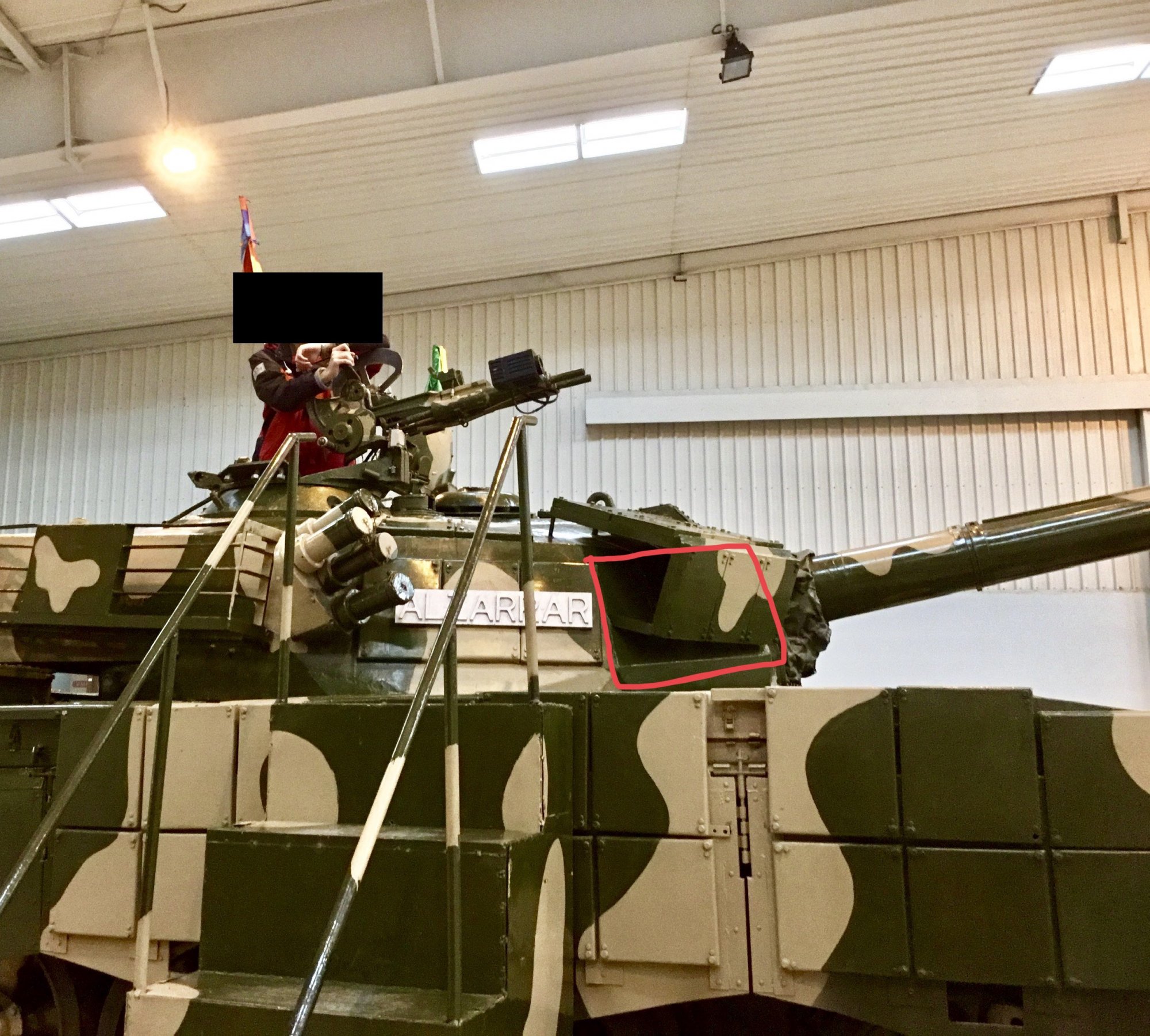

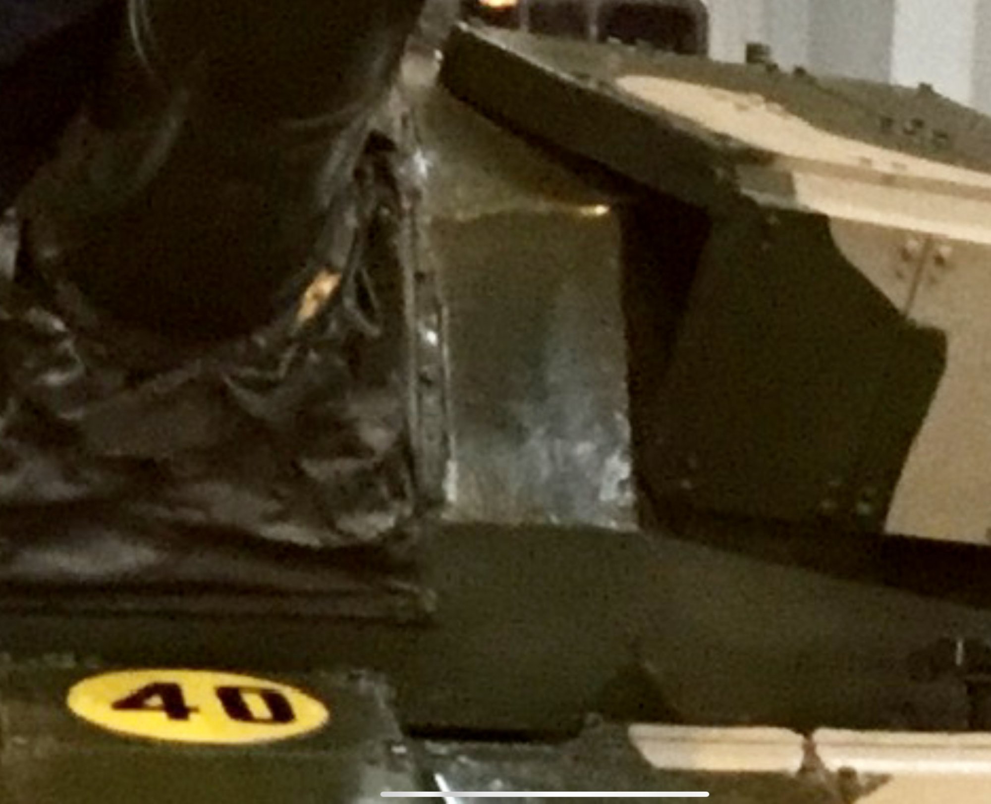

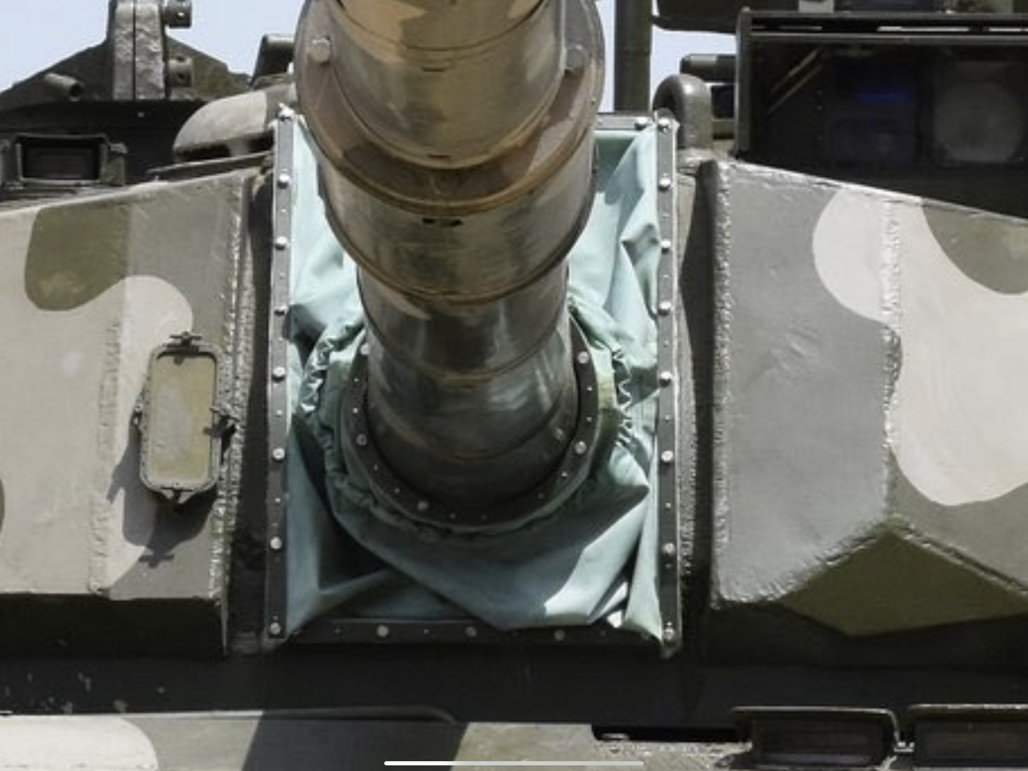

I don’t doubt the plates are HHS, but they are too thin to provide any noticeable armor increase, except for maybe against HE/HEAT projectiles by acting like spaced armor, which would be beneficial against some threats like RPGs.
When ERA is installed over the reshaping plates however, then it’s certainly an increase in armor, I do hope the army has those upgraded turret add-ons in service (the ones that go over the reshaping plates), I haven’t seen them outside of HIT.
This is most definitely just a sheet metal cover, there’s simply no space for the composites underneath or over the turret, plus this is an old AZ which in this case was traveling without its ERA even.

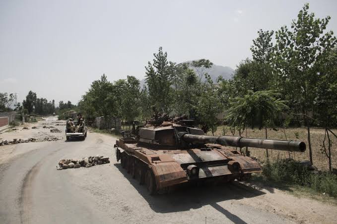

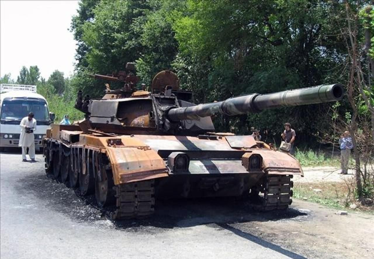

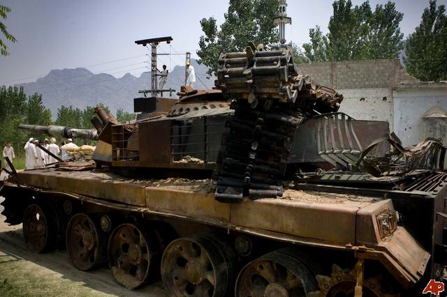

A tank like the Type 59 can survive all those (barring the SPG, this tank wasn’t hit with that), because none of them are AT weapons. VBIEDS aren’t penetrative, they will do burn and frag damage as seen on this tank, and it was indeed hit by an RPG, but an HE Round, that would likely have just torn off that metal plate, the rest of the damage on the tank is indicative of such a hit.
There was another case in which an AZ turret was hit by an SPG-7 AT round and it went clear through the front and then out the back. That’s an entirely different tank altogether, there are pictures available of that tank too.

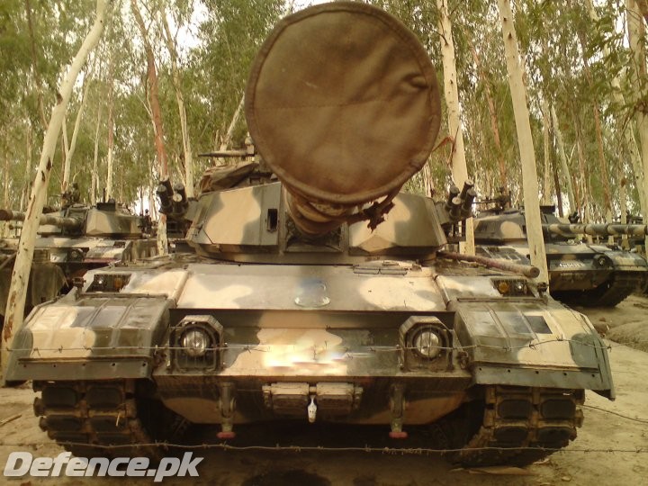

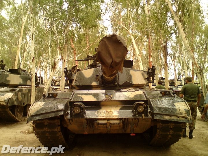

Regardless, in the pictures I posted above, the second two are of an AZ with composite armor over the turret. So they did improve it, it’s likely a bolt on upgrade that can be attached at any time.
The other tank in question, the back of the turret is blown open.
Other damaged AZs:

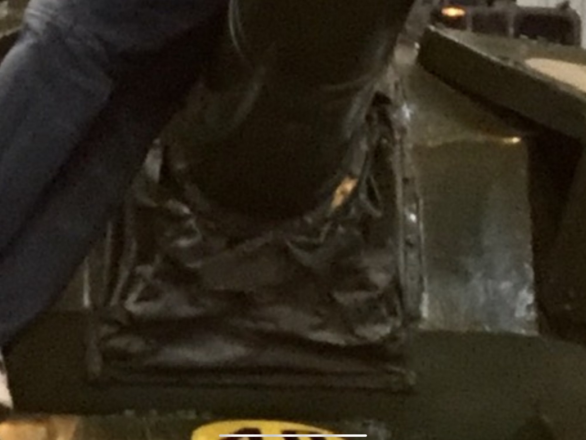

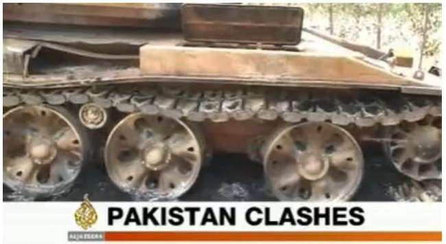

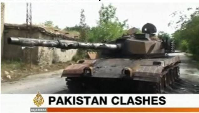

However this picture suggests otherwise since according to pk this AZ survived multiple spg, rpg and VBEDS. Metal sheet couldn't have stopped all that.
The composite block from the turret must have been removed. The metal plate which would cover it can be seen on the right side of the tank, and you can see it’s not penetrated, but rather removed. There is also no impact marks on the actual turret below, which suggests composite layer was not penetrated either. If it had just been sheet metal we would see impact marks on the turret below as that could never stop an RPG.(quote @iLION12345_1 )
