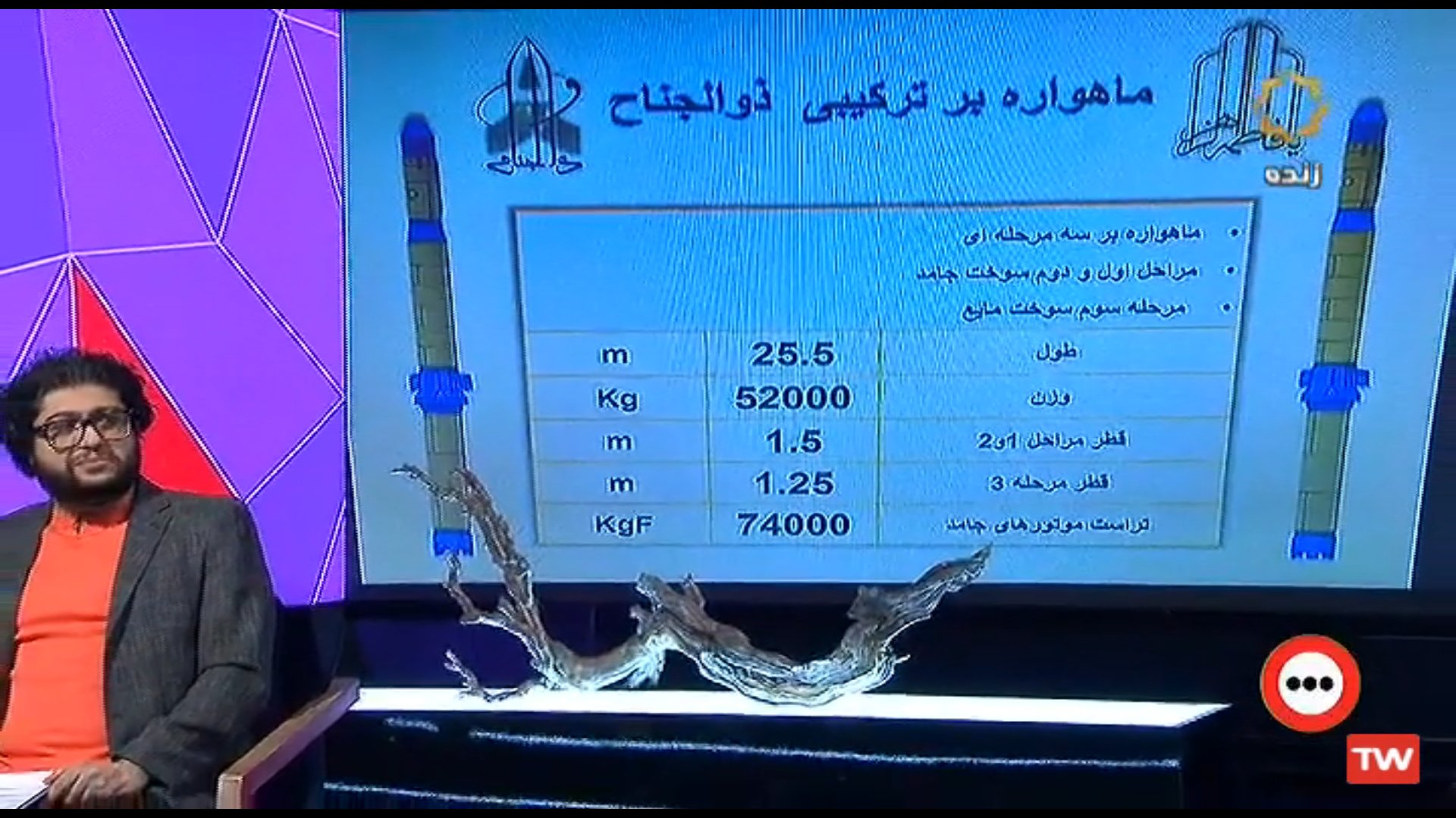

With the arrival of 22 Bahman, for the first time images have been published of the recent test of the new generation of Iranian launcher called Zolnajah.
According to these explanations, this Iranian launcher Zoljanah is in fact a three-stage rocket, the first two stages of which use solid fuel and the last stage of which uses liquid fuel.
At this stage, the rocket engine burn time of the first stage was 70 seconds and was able to reach an altitude of 15 km.
Payload capacity
The trust of the first and second stages of this rocket which are solid fuels, is 74 tons each, which can reach 100 tons.
The diameter of the first and second stage solid-fuel motors of Zoljanah SLV which are the most powerful solid fuel propellants in the whole country so far, is 1.5 meters and the diameter of the third stage is 1.25 meters.
The full length of this rocket is 25.5 meters and its weight is 52 tons and it can put a satellite weighing 220 kg or multiple-satellites with a total weight of 220 kg to an orbit of 500 km.
For comparison, it is not bad to know that the Safir-1 launcher, as the first generation of Iranian launchers had a diameter of about 1.25 meters and a total weight of 26 tons, and could finally place a 50 kg satellite into a 450 km orbit.
Liquid engine for higher accuracy
The second example to better understand the power of this launcher is that Zoljanah with its three complete stages can send about 10 satellites of the size of the Noor-1 sent into space in April 2020 by the IRGC's Qased SLV.
In the recent test, which was performed only with the first solid fuel stage, a series of sensors necessary to perform the necessary calculations to estimate the performance of the rocket systems were installed in the first stage of this launcher.

Zoljanah specs:
length: 25.5m
mass: 52 tons
diameter 1. & 2. stage 1.5m
diameter 3. stage 1.25m (derived from Safir 2. stage)
solid motor thrust: 74 tons

Specs of Zoljanah
Height: 25.5m
Mass: 52 tons
1st and 2nd stage diameter: 1.5m
3rd stage diameter: 1.25m
Thrust of solid fuel "motors": 74,000 kgF

You seriously need to stop polluting this section with your drivel. The Zoljanah has a 1.5 meter first stage as confirmed by Iran.
Specs of Zoljanah
Height: 25.5m
Mass: 52 tons
