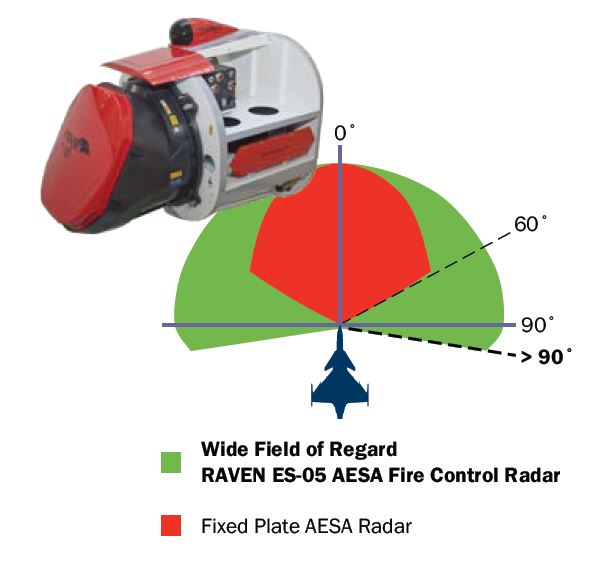

Just noticed that the scan angle of the RAVEN with it swash plate is no more than that of the KLJ-7A.
The RBE 2 AESA of Rafale is a conventional fixed AESA. The decision not to include a repositioner (swashplate) was made in the mid-1990s after a detailed study. The conclusion was drawn that though a repositioner is a good solution when the combat situation is simple, it becomes absolutely irrelevant when the battlespace becomes more complex due to a high quantity of targets spread in space. The repositioned solution was also considered irrelevant for the majority of the missions..
aircraft is not a static platform. Swash plate is a failed idea and no practical air force has opted for it.
