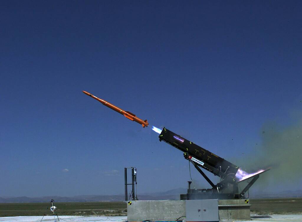

Why the missile fire in a 45 degree angle?
This first tests are done to see succesfull take off and seperation of missile from launcher.
