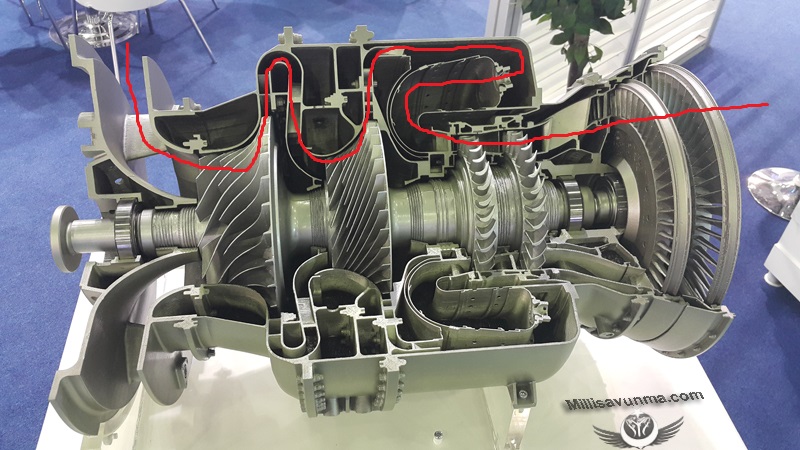

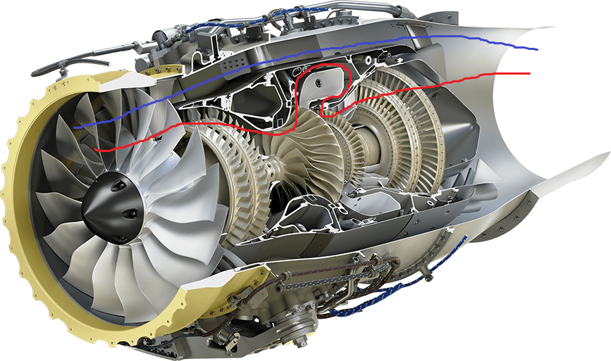

Bro, if you are having hard time to visualize the airflow going through the engines that we posted for example;
TS1400 (Turboshaft)
HF-120 (TurboFan)
Red line is the airflow going through the engine core.
Blue line is the bypass flow
TS1400 (Turboshaft)
HF-120 (TurboFan)

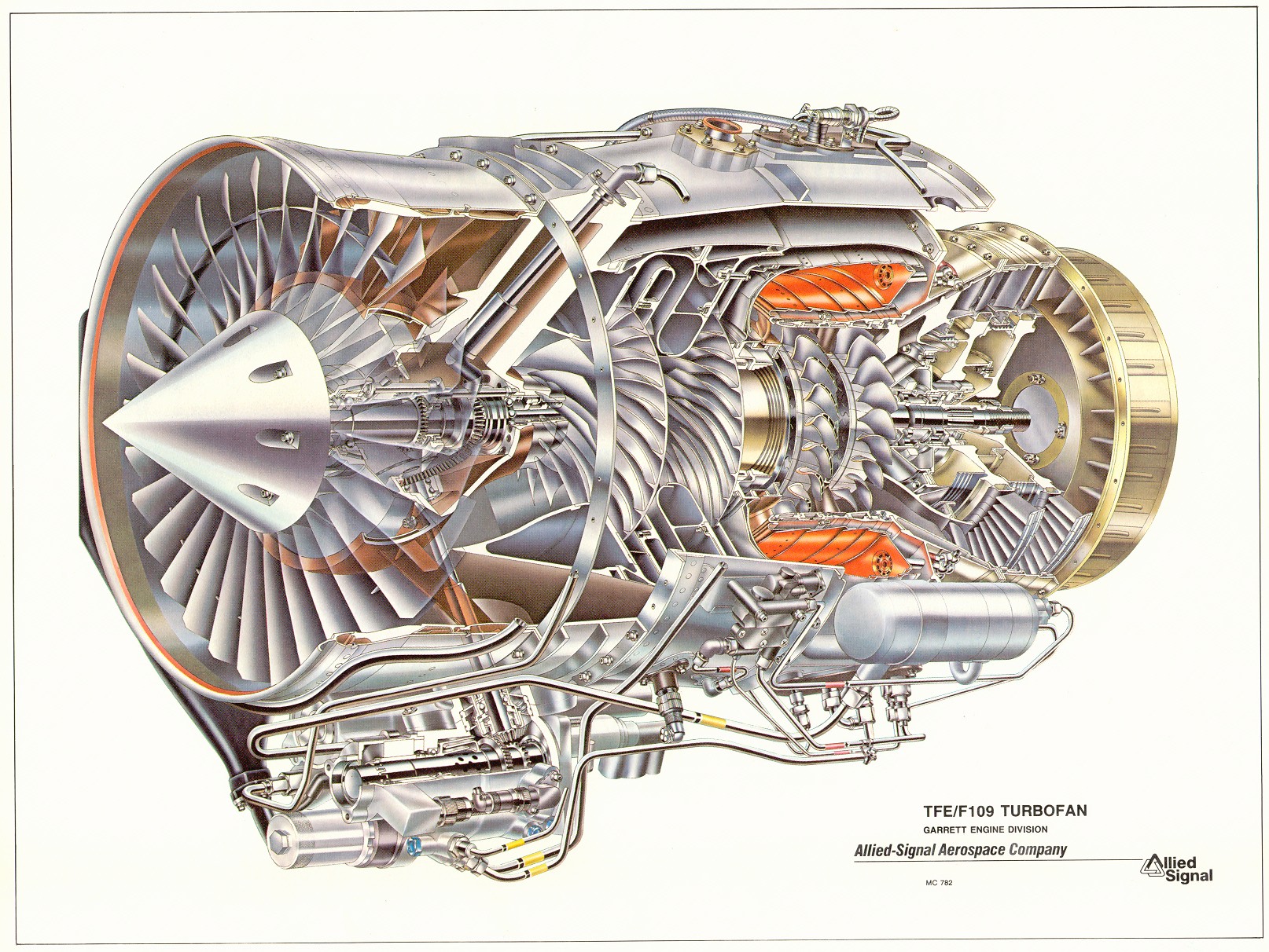

No, I believe TS1400 core could be converted into a Turbofan engine.
Garrett F109 Core is pretty much exactly the same configuration as TS1400. 2 centrifugal compressors, 4 turbines.
