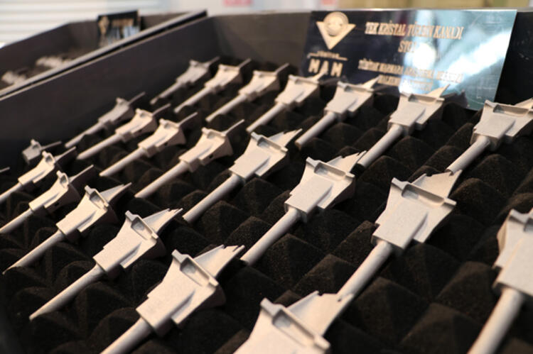

Aircraft turbine blades produced by TUBITAK MAM in single crystal form

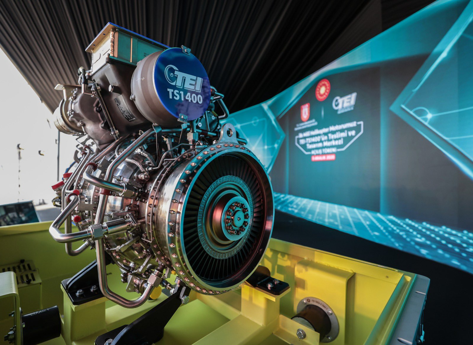

Indigenous TEI TS-1400 turboshaft gas turbine Engine for Helicopters

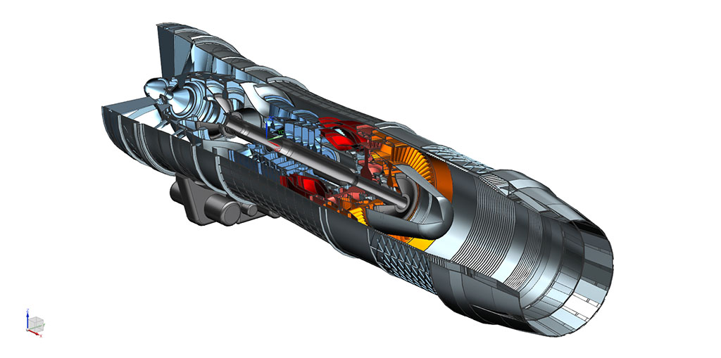

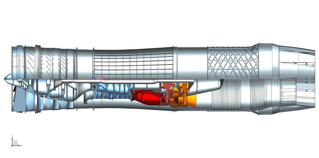

TR-MOTOR turbofan engine (27000lbf) preliminary design

also single crystal turbine blade manufacturing technology ( only USA-The UK,France,Turkey and China )

Turkey has developed 1,660 shp TS-1400 turboshaft gas turbine engine between 2017 and 2021 ( just 4 years )
in 2021 TEI has delivered TS-1400 Engines to TAI to be integrated into the T-625 Indigenous Helicopter
in 2023 T-625 Helicopter with TS-1400 Engines will make first flight
and mass production will start in 2024-2025 ..... ( just 7-8 years 2017 - 2024/2025 )
in 2018 TR-MOTOR has started developing turbofan Engine
and according to TR-MOTOR , indigenous turbofan Engine to be ignited for the first time by 2026
TF-X Fighter Jet with TR-MOTOR turbofan Engine will make first flight by 2029 ( just 11 years 2018-2029 )

In the case of single crystal blades, there's also a vast difference between a laboratory scale production and a mass production.
Do you think to develop turboshaft gas turbine engine is so easy ?
wait and see
I am saying again , if Turkey develops high performance TEI TS-1400 turboshaft gas turbine Engine then Turkey can develop also turbofan Engine
