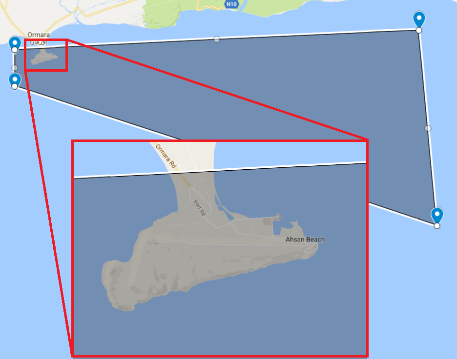

hi can any of you guys give me the notam warning issued for the launch, as i understand the launch took place late last year but i cant find the post.
Are we really sure the test we saw was conducted under THIS NOTAM? I ask because the area specified by this NOTAM only has this tiny piece of land in it:
If we assume
1- That this was the NOTAM for the Babur 3 test we saw
2- The footage we saw was from one single test
3- Babur 3 was tested at its maximum range
then we can say that is the piece of land it hit and it flew a loop around in the area to fly its maximum range. But of course, this is a lot of assumptions.

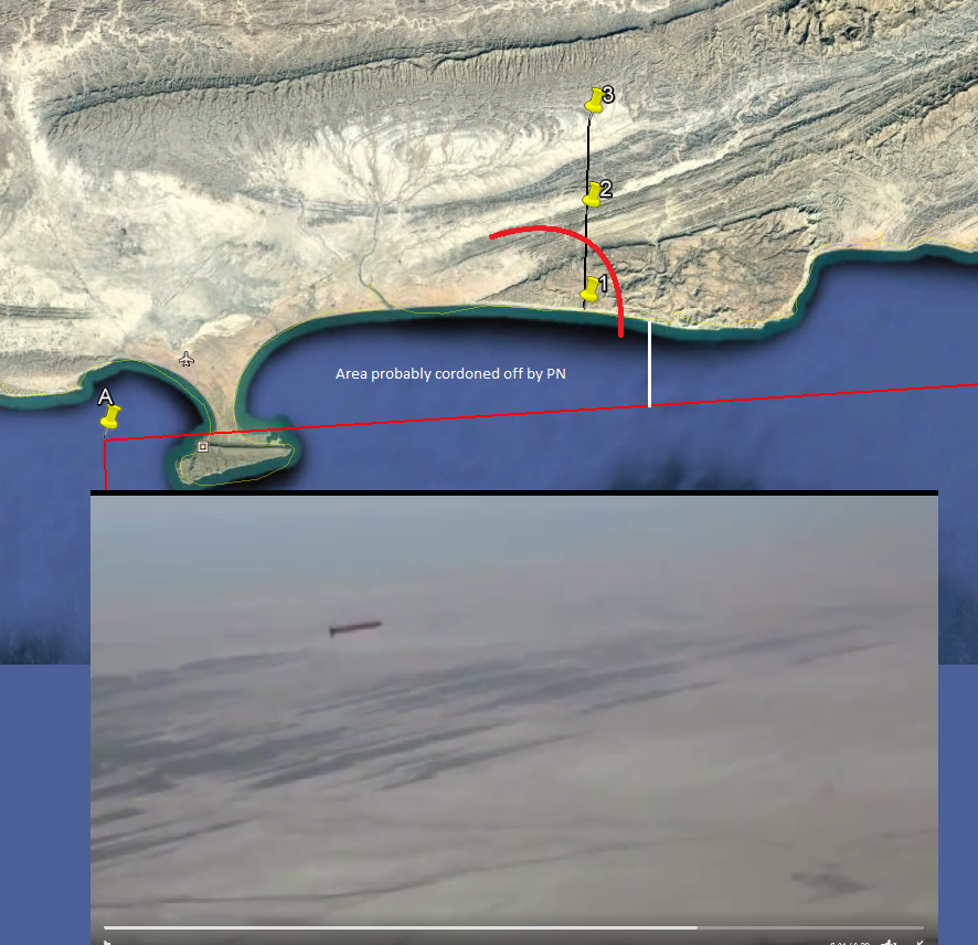

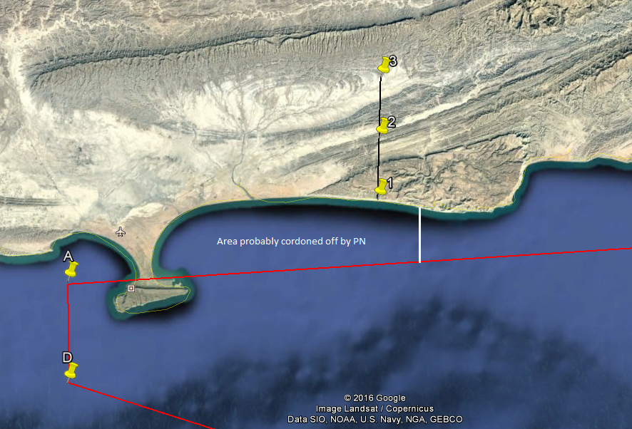

Yeah, 100% sure. Do keep in mind that this is a Naval Navigational Warning, and not a NOTAM (per se), which means this specific restriction applies to the naval traffic only. A NOTAM must also have been issued, but the CAA website is so difficult to explore, I dropped the idea.
Now, the weapon crossed over the coast approx 40km east of Ormara according to the video, an area not included in the warning. However, Ormara houses a PN base and given the magnitude of the whole thing, it must have been cordoned off manually by PN boats. Besides, that region gets blocked any way for naval traffic because of the land protrusion at Ormara.
See approx locations as shown by the video:
1. Where it crosses over land.
2. Second scene over land.
3. Most probable target region, as this area has the hills as shown in video.
(credit for geo-locating 1 & 2 goes to twitter user raj47, gotta give it where its due)

Both 1 & 2 are true. However, testing at max range isn't necessary for CMs, since after the system starts the navigation over land, everything except payload is usually verified and there is no absolute necessity for it to go too deep in-land.
(credit for geo-locating 1 & 2 goes to raj47, gotta give it where its due)
Both 1 & 2 are absolutely true, if there was any question about it, you'd hear it first from me. However, testing at max range isn't necessary for CMs, since after the system starts the navigation over land, everything except payload is usually verified and there is no absolute necessity for it to go too deep in-land. But of course it will be tested to its limits in the future.
I was trying to find those points 1,2,3 (on your map) too but it seems it has already been done! Thanks! :)
Doesn't this portion of video suggest the missile is flying westwards? I say this because notice the direction of the features on the ground and the faint coastline in the back. It doesn't seem it flew straight to the target wherever it was.
This would of course suggest some sort of terminal maneuvering.
Yeah you're right, I overlooked this. Kudos!
Anyways it was just an approximate guess. Its evident that the region north-east of Ormara is where it flew over land.
