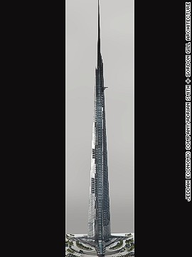

It is expected that construction of the tower will require 5.7 million square feet of concrete and 80,000 tons of steel.
