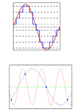

  14. Digital effects
    Almost all controllers are digital these days. Laplace gets thrown out of the window if all you want to do is digital design. All Laplace will let you do is continuous-time design with discretization APPROXIMATIONS. What you need are z-transforms so you can actually do digital design. There are aliasing effects, sampling effects, quantization effects, sampling zeros (which can be NMP). Your typical undergrad is oblivious of the existence of these effects and will kill you if you let him or her design your control system.

  14. Digital effects
