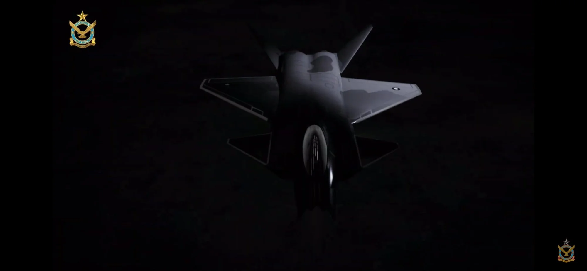

Indeed.
I had immediately googled to see if it was a copy of an existing design. It was not. The closest to it was the X-35. I could not believe my eyes.
Talking of only the design elements observable in what has been disclosed by PAF (because some details are yet hidden), the canted twin-tails are perhaps the most challenging part. The join will be very difficult. This would perhaps require Titanium & I wondered if that is something Pakistan could manage doing? It also raised a couple of questions in my mind - one of them being if Pakistan is seriously working on this. I mean just look at that join, which would undergo very high stresses. Also, the behavior of the twin canted tails in the turbulent/vortex flow was an immediate question mark. I have nearly zero study of aerodynamics, but I could see that this would also be a challenge to design around.
In case somebody has noticed, I am a bit dismissive of this design. The above are some of my concerns that lead me to be skeptical.

The second in command of Azm did not want canards because they were providing only marginal benefit at the expense of increased RCS. But for some reason the first in command of Azm has insisted on a design with canards. It would be appear that his persistence has won out. You will recall that there was also a canard-less design. This story didnt fill me with confidence because it sounded like design decisions that should be made on scientific merits were being made on egos/chain of command. Let's see what becomes of this effort. At the very least it is good practice.
Also from all that I heard it didnt appear like structural design was on anyone's minds. It was aerodynamics and RCS.

The other problem with canards with the images we have seen so far of Azm is - the FBW requirements of Azm are massive(more so that other 5th/6th gen concepts out there) since you are proposing 3 different horizontal surfaces(canards, wing, tail wings) that have to control airflow versus 2 which is the norm. So - whoever made the decision to have a "3-rd" control surface - does not appreciate the complexity of the FBW to support that configuration for a 3-axis quadraplex FBW system............
If you take what FBW has to deal with to make an unstable plane fly - then you add on top different payload considerations - some of which are assymetric in weight - then the complex scenarios that the FBW has to handle for different altitude, speed and directions go up massively... That is a lot of very very serious complex math there - has anyone seen anything in Pakistan that shows it can handle this complexity???? Germany insisted on doing the FBW for the Typhoon and it delayed the project by many many years while they worked out how to do it - and Germany has a lot more high end scientific universities that can and did help to get it to work ...
This is why I was asking about the FBW for the TFX .... i was curious - ie will it be a Turkish greenfield FBW.. If so - then a very significant achievement.
There are few instances of operational frontline planes with 3 surfaces - Su30MKI counts as one of them and a suite of of experimental planes.
