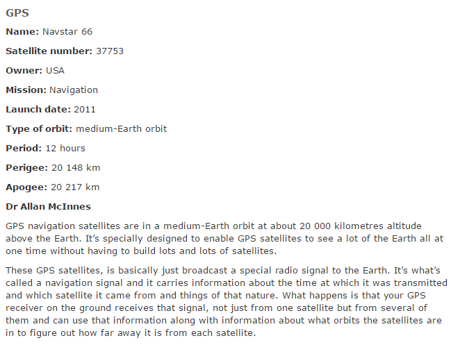

There is nothing at 20KM. Those are more like SatCom baloons than Satellites. A modern SAM can take out crap at 20 KM. Current GPS systems are at 200KM-3500KM (mid-the beginning of the upper atmosphere).

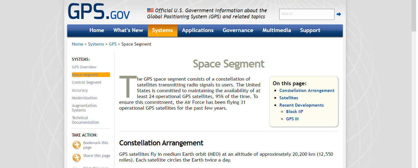

Official U.S. Government information about the Global Positioning System (GPS) and related topics
http://www.gps.gov/systems/gps/space/
GPS = Mid earth = 20K
http://sciencelearn.org.nz/Contexts/Satellites/Sci-Media/Interactive/Satellites-and-orbits
What's your qualification in this field? This is when that scene from that movie I saw a while ago becomes a reality. A man is trying to teach Japanese to a Monkey. Well the result is that the Monkey runs away to the trees frustrated and the man wants to bang his head on a wall with Frustration.
Your link provides details on the CURRENT GPS system. If you read CAREFULLY, my post will tell you that the first two generation of Satellites, including the current GPS systems were all new concepts and for the lack of a better term, exploratory. But today, and in 2016 (NOW), the space tech has advanced a LOT since the launch of the GPS> And everything is on a much different scale. For future stuff, you don't see links on the current GPS. You follow the NASA. What I posted, has elements from NASA and I had outlined that below.
Please don't waste time in constant back and forth because you want to be "right". You should learn a topic before constant back and forth showing lack of proper knowledge on the subject.

GLONASS = 1982 = Mid Earth Orbit = 20K
GPS USA = 1978 = Mid Earth Orbit = 20K
