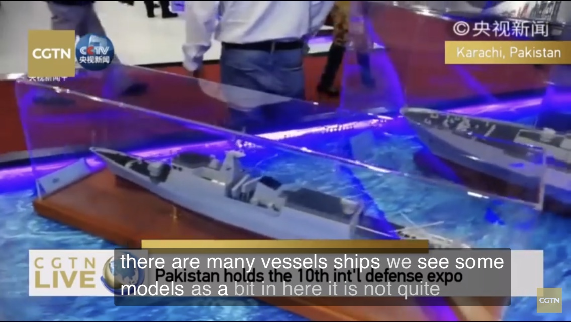

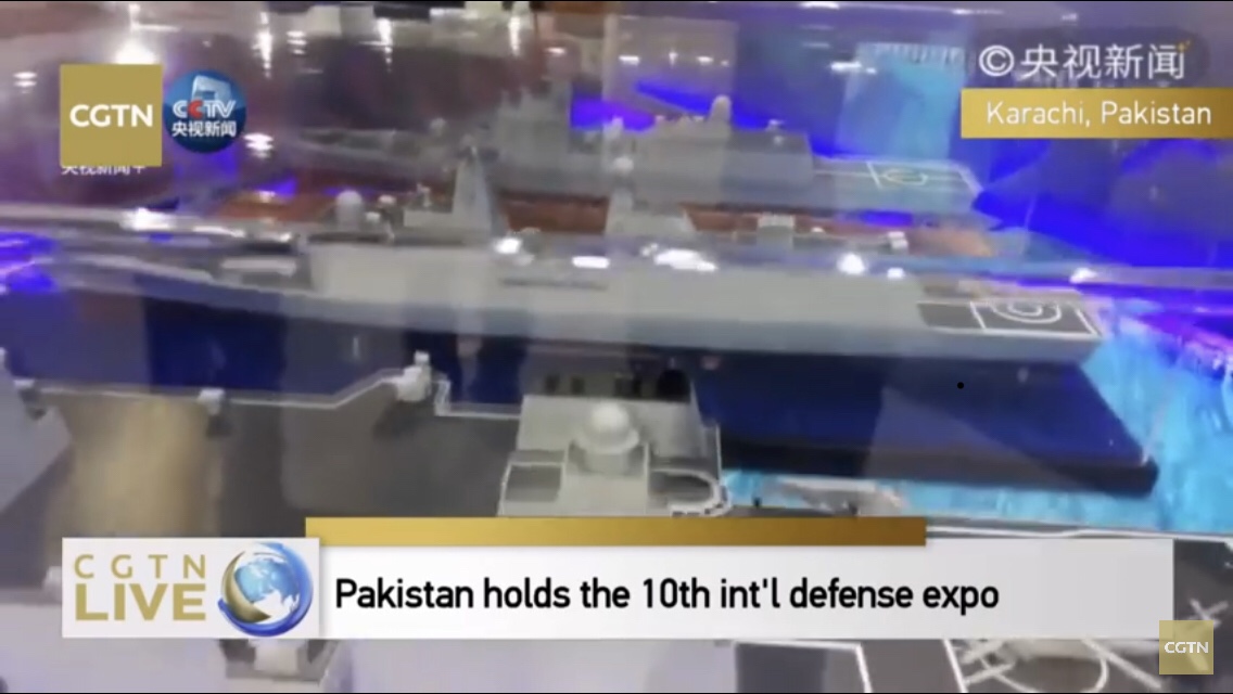

China will export 054A frigates to Pakistan. Performance is better than self-use.
December 06, 2018 10:07 Sina Military
054A export-type frigate model, pay attention to its radar
In June this year, the Pakistan Navy announced that it would introduce four 054A missile frigates from China. On the IDEAS-2018, Chinese related units exhibited the 054A export-type frigate model. After the service, the ship will effectively improve the Pakistan Navy's combat capability.
From the relevant model, the 054A frigate's export-oriented main system and ship-borne weapons are upgraded, and the overall performance is more advanced than the Chinese Navy's own-use type. It can be seen that China attaches importance to this project.
Chinese Navy 054A frigate, which uses Sea Eaglo S/C Radar
The Indian Navy also uses roof radar
The most obvious change of the 054A export frigate is to replace the original Sea Eaglo S/C three-coordinate radar with the domestic SR2410C radar. The latter is based on the improvement of the Russian Roof three-coordinate radar.
The roof radar is a frequency sweeping array, which uses the frequency change to change the beam pointing, so the electronic countermeasure capability is affected. In contrast, the SR2410 radar uses a phased array system, which uses phase changes to change the beam pointing, and the frequency does not need to change. The electronic countermeasure capability is stronger, and the frequency sweeping array is gradually replaced by the phased array in the new century. This is the reason.
In addition, the SR2410 radar adopts an active phased array system to realize two-dimensional electronic scanning. Especially after detecting the target, it is possible to quickly turn the beam back to confirm, and it is not necessary to rotate the circle like the roof/sea eagle radar to confirm the target. Faster, it can better combat supersonic anti-ship missiles and saturation attacks, so it will be equipped with enhanced 054A export-type frigate combat capability.
Export-oriented domestic SR2410C radar
Above the model, we can also see the missile-illuminated radar, which indicates that its ship-to-air missile is still the Red Flag 16 ship-to-air missile, possibly its export-type LY-80N ship-to-air missile.
It is said that Pakistan has introduced the Red Flag 16-export anti-aircraft missile-LY80 anti-aircraft missile. Therefore, the 054A export-oriented frigate has strong versatility with the LY-80 anti-aircraft missile in terms of logistics support.
The LN-80N ship-to-air missile has a maximum range of about 40 kilometers. It can extrapolate the ship's air defense capability to the water antenna, which not only provides air defense cover for the ship, but also provides a certain air defense barrier for small ships.
The missile adopts the radio command plus relay inertial navigation plus the terminal semi-active radar guidance system. It has strong anti-interference ability and low-altitude interception capability, and can intercept the attacking sea-skimming flight target and supersonic anti-ship missile.
054A export frigate equipped with LY-80N ship-to-air missile
The 054A export frigate still uses two sets of square quadruple anti-ship missile launchers, so its anti-ship missiles may still be the C-802 series. These missiles are also large amounts of equipped in the Pakistan navy, including the Type F-22P Frigates and the Azmat Class Fast Attack Craft Missile etc.
In the future, the AIP submarine imported from China may also be equipped with its submarine-launch type. The PAF JF-17 fighter aircraft can also launch the C-802 airborne type. Of course, the 054A export-oriented frigate may be equipped with the latest improved version of the C-802 series missile. -C-802B anti-ship missile,
Compared with the C-802A now equipped by the Pakistan Navy, it has a longer range, from 180 km to 290 km. The guidance system has also been upgraded, and the active/guided composite radar guidance system has been upgraded from the active radar homing(ARH) for terminal guidance system. It is also possible to modify the radar/infrared imaging guidance system to improve the missile's strike capability and anti-jamming capability.
Anti-ship missiles may be upgraded to C-802B anti-ship missiles
The 054A export frigate is basically the same as the 054A frigate, including the 76mm naval gun and the Z-9EC Anti-submarine helicopters. These weapons are also installed on the Pakistan Navy F-22P frigates.
Therefore, the installation of these weapons by the Type 054A export frigate is conducive to the early formation of combat capability of the ship, and can also save the cost and expenses of logistics support, which is very valuable for Pakistan with limited economic strength.
On the whole, the 054A frigate exported to the Pakistan Navy has adopted the latest domestic technological achievements, and its overall combat capability has been greatly improved compared with the existing 054A frigate, effectively enhancing the Pakistan Navy's combat capability. The Chinese Navy 054A frigate will be Medium term overhaul in the future. These equipment and weapons should also be replaced during the overhaul.
