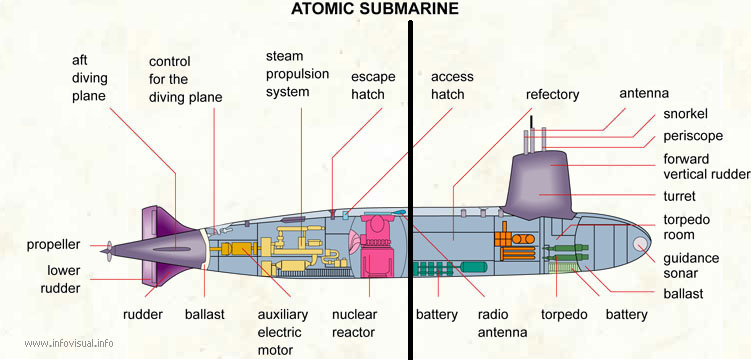

The displacement for nuclear propulsion submarine is 3 times that of AIP submarine.
Nuclear propulsion system as the tenant, occupies lot of space of the sub.
It occupies almost half the sub space:
Propulsion does occupy nearly half a nuclear sub. However, not all of propulsion is the nuclear part. So, in effect, the nuclear component is more like a quarter or less of the boat length.
The Shortfin Barracuda is 97 metres in length and displaces 4,500 tons when surfaced. This conventionally powered, AIP equipped sub will be a version of DCNS's 4700-tonne nuclear-powered Barracuda submarine (SSN).

We know of AIP submarines that have displacement of 1600 tons.
But have you seen such a displacement, when we talk of Nuke subs?
You wont find any.

This was your original statement "The displacement for nuclear propulsion submarine is 3 times that of AIP submarine."
As such, that means any nuclear submarine and any AIP submarine. This simply is not true.
First of all, you really mean SSBN only. SSNs are significantly smaller than SSBNs but still have nuclear propulsion.
Second, whether with or without AIP, the displacement of SSKs varies, from as little as 500-1000 tons to as large as 4000-4500 ton.

What is the lowest displacement number for "operational" SSNs ?
And what is the lowest displacement number for "operational" AIPs?
Once you have the right numbers. I would not have to post again on this to prove my point. Cause that would be self explanatory for what I meant, when I replied to T-Rex.
The crux of the matter here is, that the nuclear boats are supposed to be bigger than AIP, and this IS the case normally.

The Russian Amur class AIP subs start with displacement as low as 700 tons while SSNs start with 5000-6000 tons. Yes, I can see that SSNs are very large vessels compared to the AIP subs. That's why miniaturization of nuclear reactor comes into the scene.
