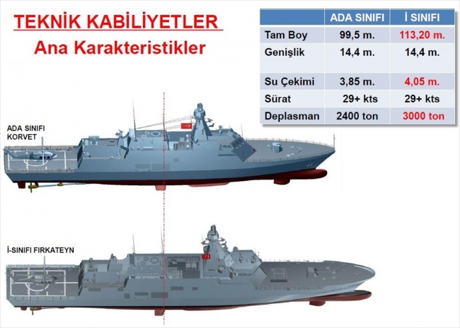

I think the MILGEM Ada can handle at least two Sylver A43 sets (i.e. 16 cells). Adjacent placing (of each set) might preclude the need to push the main gun up. We might be able to take it to 32 cells if the gun is moved up the bow by 2-3 metres.
It may indeed fit, but may need to be in a V-pattern with each 8 cell group tracing the bridge structure (8 slanted on Left and 8 cells on right). Not sure how it would affect the balance of the ship, if it would be too front heavy. The other issu is that you would lose 1 deck level below the VLS. So what was there? Where can it be moved? Thats one of the advantages of simply stretching the ship. You gain deck space below too.
