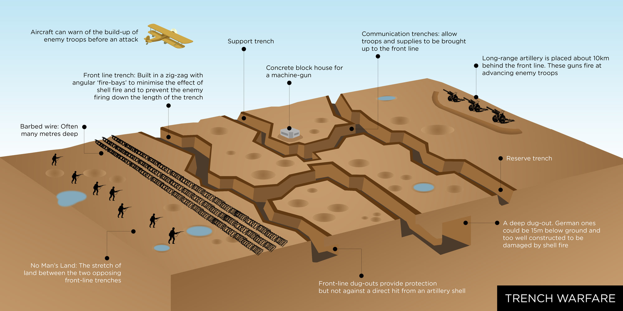

Check this please, so could look the enemy defence lines in a Indo-pak scenario, its not anymore 1965, both side are building since 50 years bunkers and trenches a long the Border.
