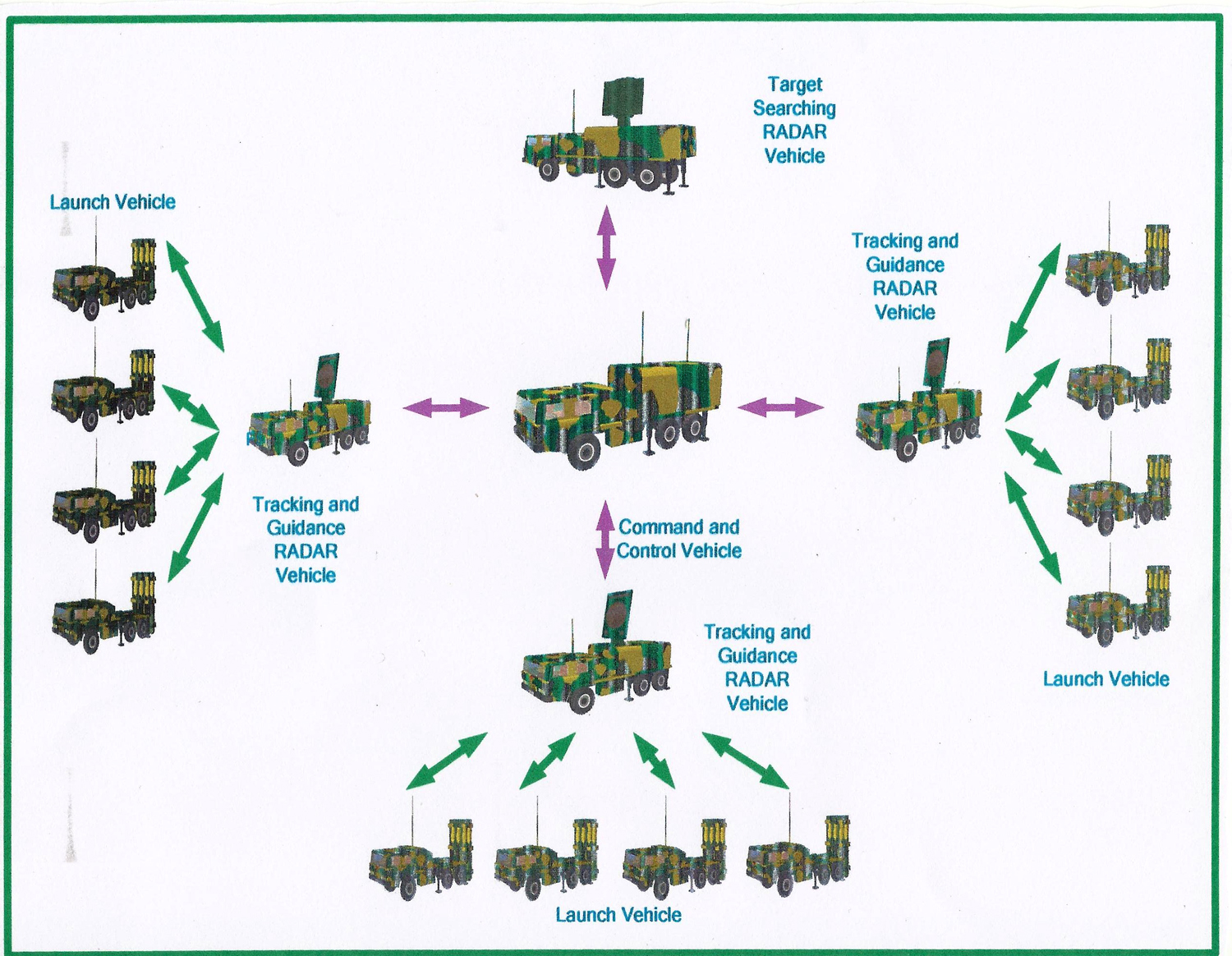

8 batteries x 3 launchers in each battery x 6 missiles per launcher = (8x3x6) = 144 missiles ready in tubes
Wrong. Each system has 1 search radar, 1 command vehicle and 2-4 batteries or Firing Units (3 in case of Pakistan). Each battery or FU has 4 launchers.
Pakistan has purchased 8 IBIS-150 radars for LY-80. So, number of batteries will be 8 x 3 = 24
No of launchers will be 24 x 4 = 96
No of ready-to-launch missiles will be 96 x 6 = 576
Below image is from official website of ALIT.

The Pakistan Army has inducted the Chinese-built LY-80 self-propelled surface-to-air missile (SAM) system, according to a 12 March statement issued by Inter-Services Public Relations (ISPR), the media wing of the Pakistan Armed Forces.
General Qamar Javed Bajwa, the Pakistan Army's chief of staff, was quoted by ISPR as saying at the induction ceremony that the low-to-medium altitude air defence system is set to increase Pakistan's "response capability to current and emerging air defence threats".
The LY-80 is the export variant of the HQ-16 SAM system, which is used by China's People's Liberation Army.
The basic LY-80 unit consists of a command-and-control (C2) cell made up of a surveillance radar vehicle and a C2 vehicle and three firing batteries.
Each firing battery consists of a tracking and guidance radar vehicle and four vertical launchers each armed with a missile pack containing six launchers.

I believe this is the Pakistani config of a battery.
1 battery = 3 firing units
1 firing unit = 4 launchers
1 Launcher = 6 missiles
1 battery = 72 missiles
8 batteries = 576 missiles
A battery is smallest independently operating system so 1 search radar plus min 1 tracking radar plus launchers so in the above figure 1 IBS-150 plus 1 tracking/guidance radar and 4 launchers is one battery or you can have more than one guidance and more than 4 launchers tied to IBS-150
Max battery/unit is dependent Upon IBS-150
1 system = 3 batteries or Firing Units.
