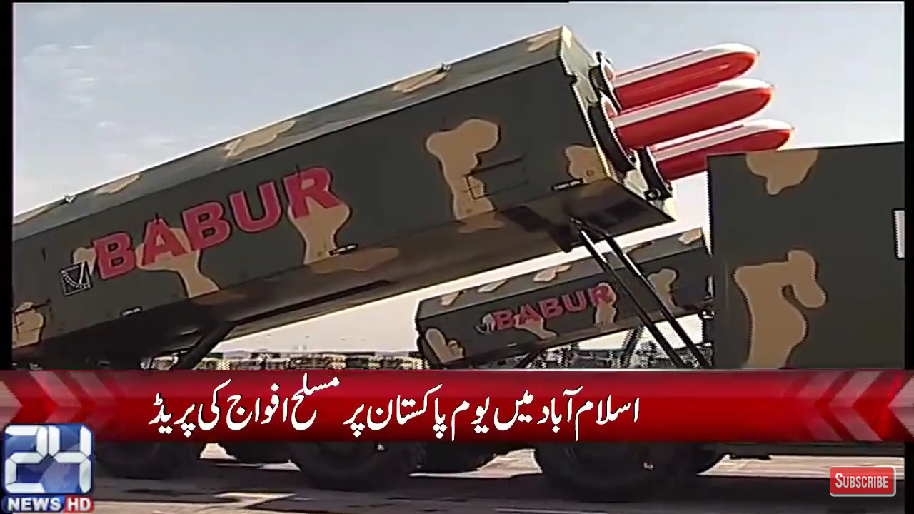

My assessment about the "Harba" missile.

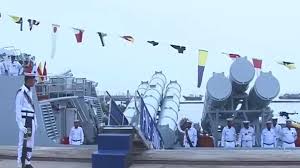

Since people were talking about the two triple missile launchers on the latest FAC(M)
Now, here is what I see as a lot of resemblance with babur's arrangement in this picture.
The roughly triple launchers ignoring the casing.
