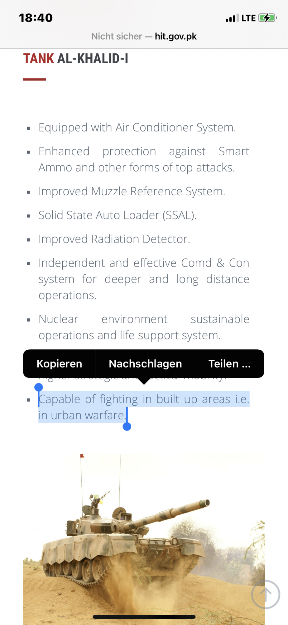

@HRK what special urban fighting capabilities does the Alkhalid -1 offer as claimed by HIT ?
not exactly but somewhat similar to Urban warfare kit of T-72 tank; in Pakistan we learn it from our past experience of deployment of T-59/T-69 tanks in FATA region same additional safety measures against mines, IEDs and RPGs could be applied to AK as well, but as far as I am aware no AK is ever displayed with Urban warfare kit till now so we can not tell the exact details.
