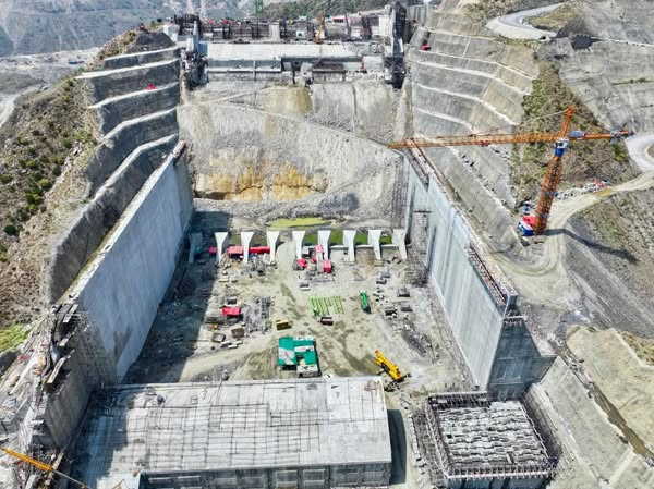

Power Tunnel & Waterway Overview – Mohmand Dam Project
The Power Tunnel & Waterway of the 800 MW Mohmand Dam is a crucial component of the project, designed to efficiently channel water from the reservoir to the powerhouse. It features a combination of concrete-lined and steel-lined sections to ensure structural integrity and optimize water flow.
This tunnel, having a diameter of 13.2 m conveys water to the powerhouse through a set of manifolds/penstocks which will house 4 generating units..
Key Specifications:
Diameter: 13.2 meters
Total Length: 730 meters
Concrete-Lined Section: 381 meters
The first 126 meters has a gradient of 6.65%.
The remaining 255 meters is inclined at a steeper 10.6% slope.
Steel-Lined Section: 349 meters
Under normal reservoir operation, The power intake will remain under submerged conditions thus ensuring efficient water flow into the waterway untill powerhouse. This innovative design enhances the operational efficiency of the powerhouse and underscores the advanced engineering efforts at Mohmand Dam.

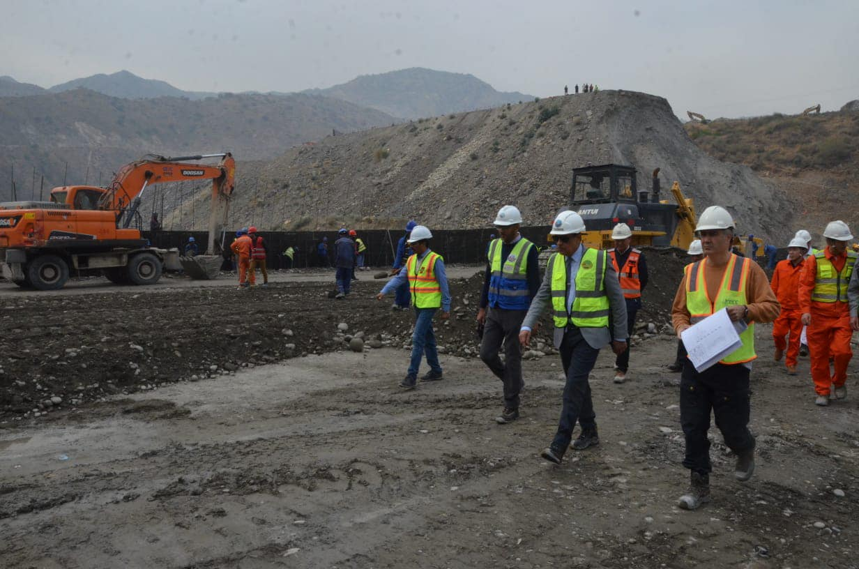

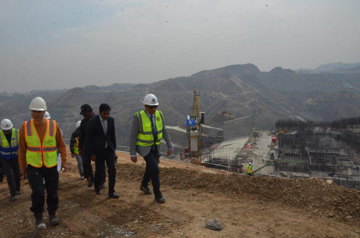

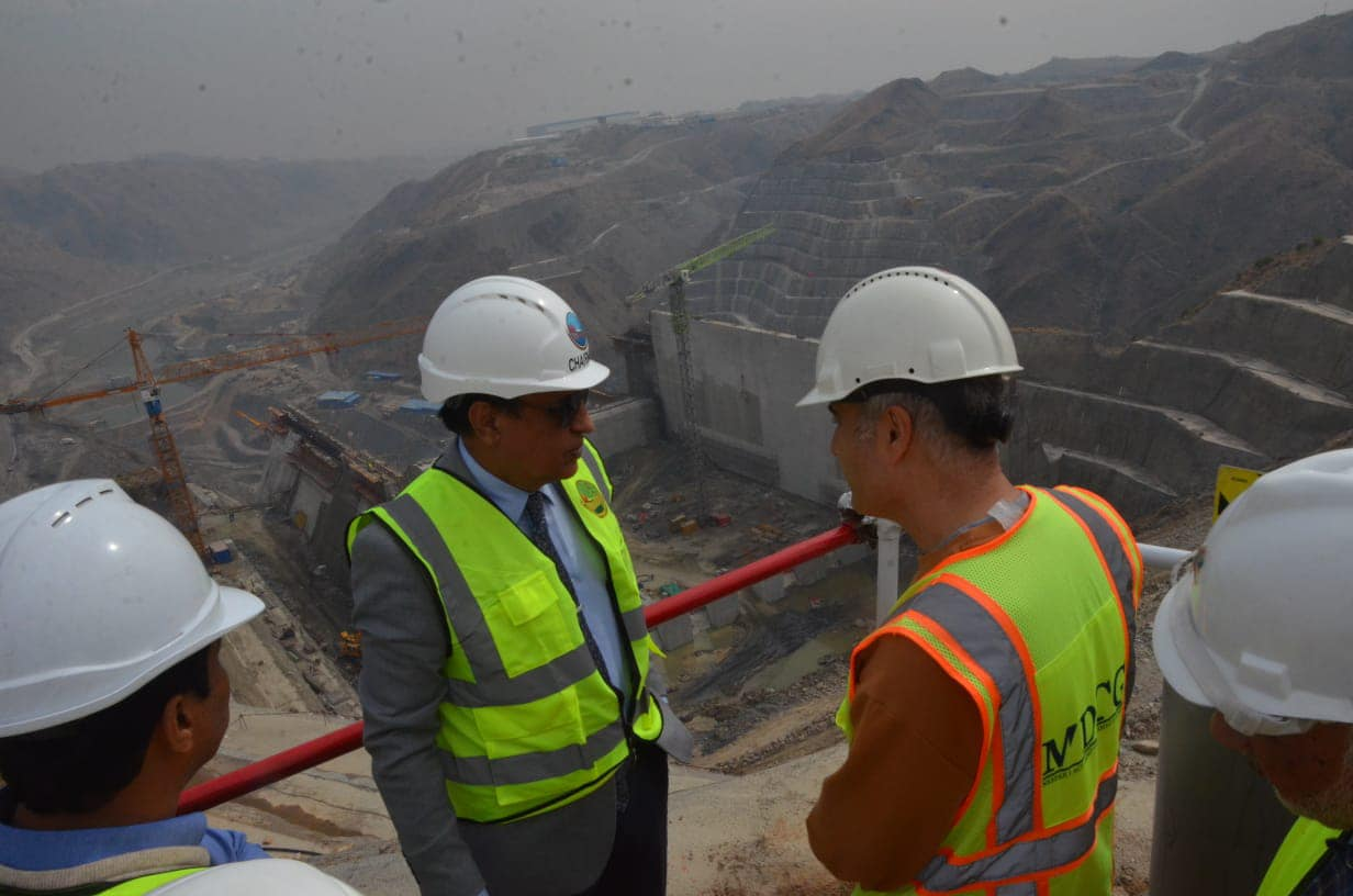

January 06, 2025: Chairman WAPDA Engr Lt Gen Sajjad Ghani (Retd) visited Mohmand Dam, a multipurpose project being constructed across River Swat in Mohmand District of Khyber Pakhtunkhwa, and reviewed the ongoing construction activities carried out at the key sites of the project.
During his visit, Chairman WAPDA Engr Lt Gen Sajjad Ghani (Retd) was briefed about the construction in progress at different sites of Mohmand Dam Project that include Diversion Tunnels Outlet Works and Downstream Coffer Dam, Powerhouse Excavation and Shaft Access Tunnel, Spillway Concrete Works, Main Dam, Pit and Plinth Excavation/Concrete Works, Downstream Coffer Dam and Diversion Tunnels Inlet Structure, Power Intake on-going works.
Chairman WAPDA was accompanied by the General Manager/Project Director Mohmand Dam Project with his team and representatives of the Consultants and Contractors during his visit.
The Chairman also presided over a progress review meeting to meet the timelines in accordance with schedule for completion of the project at the project office with WAPDA team, the Consultants and the Contractors.
The matters related to construction in progress on Upstream and Downstream Coffer Dams, Dam Plinth, Foot Print and Pit Excavation Powerhouse, Power Intake/Tunnel Quarry Development and Large Scale Triaxial Results and Spillway Concreting were discussed in detail to achieve the target of timely completion scheduled in 2026-27.
