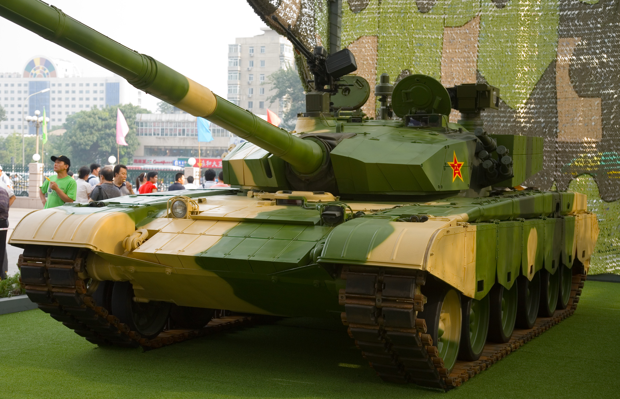

Although there are similarities, people are jumping to conclusions here. Alot of tanks can look quite similar, this tank, if it even is the karrar, it does indeed have T- series influences such as side skirts etc however, there is clearly considerable differences. Look at tank below:
If you look close enough you could also see similarities between it and T-90 etc, however does that mean it is based on it?
