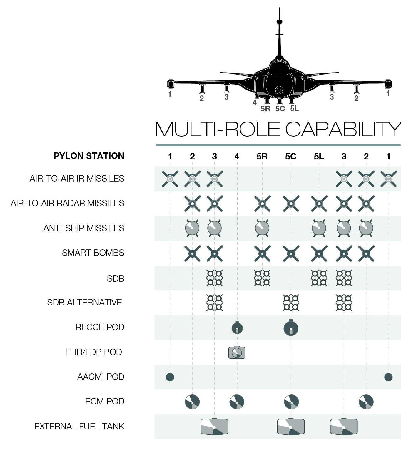

I am a fan of the landing gear redesign in the Gripen E that increased internal fuel capacity from 2270 kg to 3400 kg and allowed the aircraft of similar size to the JF-17 to have 3 hardpoints on its fuselage.
With 6 wing hardpoints similar to the JF-17, and 3 on the fuselage plus targeting pod and gun under the two engine intakes, the aircraft can carry loadouts like:
- 7 BVR+2 WVR
- 2 fuel tanks, 5 Meteors and 2 WVR.
- 2 fuel tanks, 2 WVR, 2 BVR, 8x SDB
Adding two more hardpoints to the wing will require further strengthening it and likely reducing space for fuel, but adding them to the fuselage like on the Gripen can actually increase both internal fuel and weapons capacity.
Images for representation:
