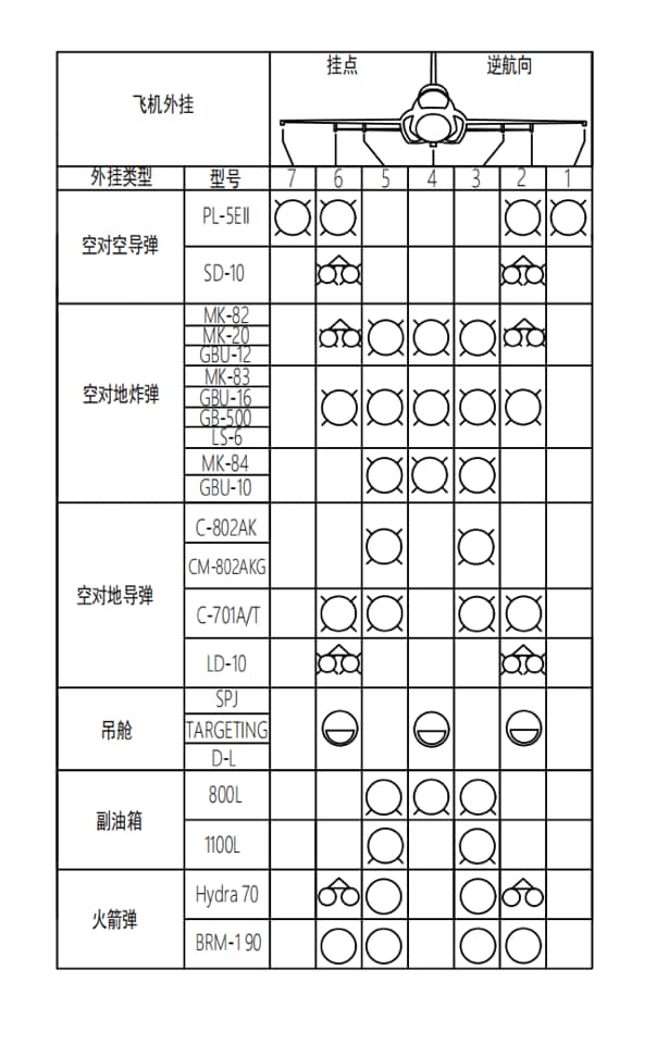

Not sure why multi racks on pylons other than 2 and 6 are not an option may be clearance ??
Also sd-10 and ld-10 cannot be mixed on dual rack ??
Unless just to keep the configuration on the layout clean
Seen a dual rack on fa-50 carrying aim-120 and Mk-82 on dual rack on either side
not sure about the mixed dual racks but dual pylons on 2 and 6 is an option and might be done soon.
