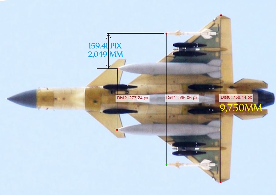

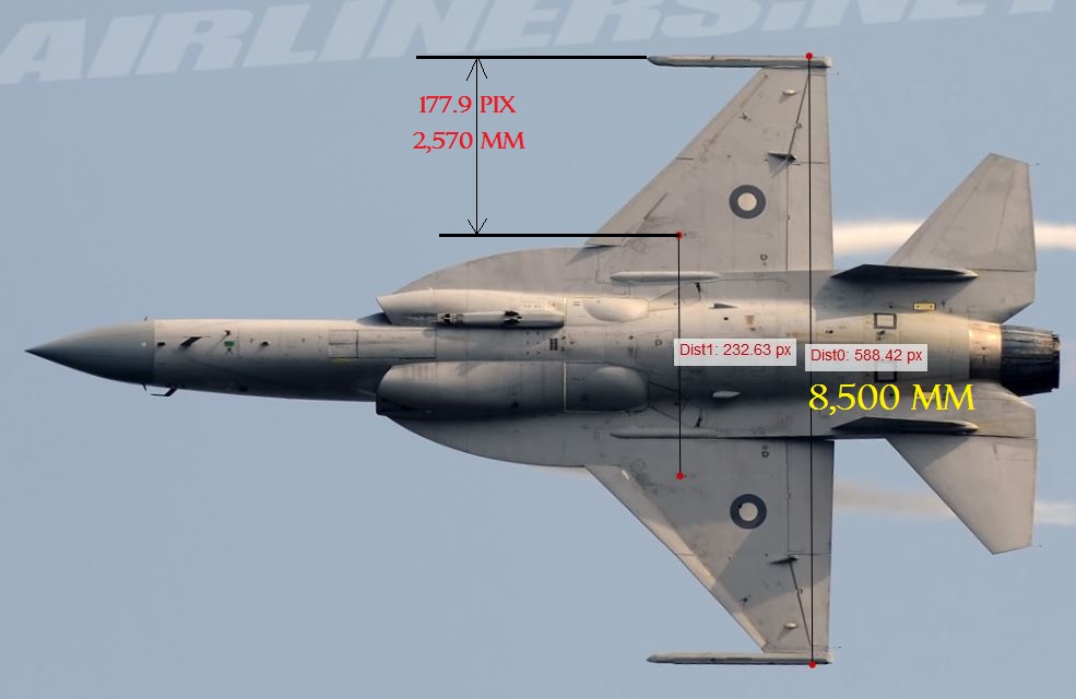

Finally managed to do the exercise I have been meaning to do and I am surprised with the answer I have. There is more space on the JF-17 for the twin SD-10s than on the J-10. There is about 2m on the J-10 and about 2.5m on the JF-17/FC-1. I.e. If they fit on the J-10, they should fit on the FC-1.
I am a bit surprised. Maybe I made a mistake. It is late, so I welcome those who can double check to comment. ... ... Yes I have not included the radius of the EFT!!
On the JF 17, the wing area, position of the gun and the landing gear are the main hurdles in additional hard points. The design being mainly Chinese, one wonders if this was a bit deliberate to make it cost effective as well as to make room for additional capability that was to be provided by the FC-10/J-10 that the CHinese were hopeful Pakistan would import at the time when the JF-17 was in design phase. All possible.
Changing the base design once in production is not easy.
On the JF 17, the wing area, position of the gun and the landing gear are the main hurdles in additional hard points. The design being mainly Chinese, one wonders if this was a bit deliberate to make it cost effective as well as to make room for additional capability that was to be pprovided by the FC-10/J-10 that the CHinese were hopeful Pakistan would import at the time when the JF-17 was in design phase. All possible.
If that's the case J10 should have the same problem it has a station next to the gun (4 point attachment)
You can always design around it like Mirage and Rafael intake pylon which pushed the pylon forward of the attachment to avoid landing gear doors limitation
Even Mirage 5 has 2 intake pylons which are not being used by PAF (never seen ative on PAF A/c)
there should be issues for making a pod hard point below air intakes, as space is not that much limited there for small items..but again that is just an opinion of an amateur
