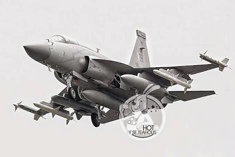

Look at the picture below.
That would be this picture...
https://defence.pk/pdf/attachments/thunder-loaded-jpg.469378/
One wing has a C-802 which is ~750KG, on the other wing it is carrying a 800litre fuel tank to balance it out. The aircraft fuel management system and FBW will have to work together.
For the highlighted, where is the technical supporting doc?
If missile not fired the aircraft computer will manage fuel via pumps so that the the opposite wing has similar weight. Once missile fired, the fuel management system will pump out fuel from the wing with the tank and balance rest of the aircraft.
In the absence of supporting technical doc for the previous statement, this following one is flat out wrong.

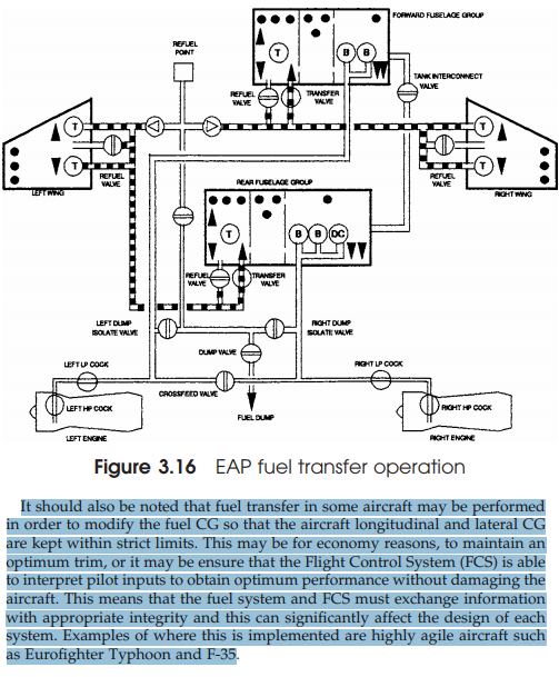

The main argument is
1. Aircraft CG can be altered by re distributing fuel. Which you've also agreed.
2. It can be automated by FCS (FBW and fuel management system) which you say is not desirable.
3. You want proof that JF-17 has such a system.
4. Not your query. It's regarding Raad load out. Will answer later, don't have the time to answer that right now.
I'm very disappointed in the explanation you gave, you had me worried that I was going to be proved wrong. That was really arrogant of you. And infact did some further reading on the topic to to confirm my hypothesis.
No matter how much experience you have you should always be receptive to new ways of getting something done. Doesnt matter if he's Chinese Pakistan, Indian or any XYZ nationality he might point out something new. Your nationality or experience does not give youre IQ any advantage.
You say you've worked on F-16 and F-111. F-111 is a dinosour won't go there but the F-16 fuel management system details are available online. In the F-16 you can manually shift between front and aft tank to shift CG.
Yes normally there is sequential transfer of fuel between tanks but the system can be controlled via cross feed pumps to manage a mismatch or alter CG manually. And in more modern jets it can be managed by the flight control system. This is the thing you are not agreeing to and that the JF-17 doesnt have such a system, you want proof.
I'm sharing extract from a book please read last four lines of extract to confirm FCS and fuel system can work together and such systems exist on F-35 and Eurofighter.
Aircraft Systems: Mechanical, Electrical, and Avionics Subsystems Integration
https://books.google.com.pk/books?id=Hcgh8SturJQC&pg=PT157&lpg=PT157&dq=eurofighter+fuel+crossfeed&source=bl&ots=x3vXr8p_fg&sig=7tjigkW8GuInxEndCiAN7bOeb1I&hl=en&sa=X&ved=0ahUKEwiLlqy4_draAhULso8KHSSAD54Q6AEISDAF#v=onepage&q=eurofighter fuel crossfeed&f=false

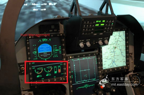

Now coming to JF-17, while searching on fuel management systems came across a English translation of the Mig-29 handbook it states if equipped with fuel tanks both sides must have equal fuel. And the sequential system pumps fuel from those external tanks to wing and then the main tanks. Same likely holds for most jets you see carrying equal amount of fuel both wings. Likely why F-16 only uses aft and front load to manage CG and not wing load as it can't handle asymmetric fuel loads on the wings.
Reason why I'm saying JF-17 must have a automated mechanism to balance fuel and
resultantly alter CG is because otherwise this loadout configuration in the picture is not possible.
It's carrying a asymmetric fuel load and if flight in this configuration is possible it's FCS must be managing fuel transfer on wings.

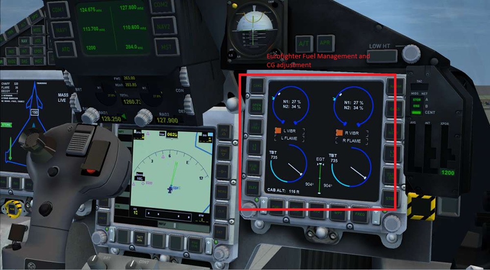

Now coming to aircraft fuel tank configuration. For combat aircraft and commercial there is a difference. Combat aircraft have more smaller tanks whereas large commercial planes have fewer number of larger tanks.
For imbalance of wing load since wings on a fighter are smaller wing loading imbalance does not have too much impact and can usually be controlled by trim setting. In large commercial planes fuel transfer is used since the size of the tanks makes a bigger impact on CG.
But this does not mean the same technique cannot be used on a fighter jet as well. If the imbalance is too large since everything is now electronically controlled its not too far fetched to believe fuel crossfeed can be used to augment the trim setting. Down side of using trim is it creates unwanted drag and affects range. Since electronic systems are advanced enough the CG method (eg front, aft, left right) has
benefits if enough fuel still on board.
https://aviation.stackexchange.com/questions/3853/why-do-planes-have-cross-feed-switches-or-circuits
"To keep the plane balanced, both wing tanks should have about the same amount of fuel. However, for various reasons, they could become unbalanced. The crossfeed valve allows fuel to flow from the tank with too much fuel to the tank with less fuel."
777 fuel system
JF-17 Fuel system similar to Eurofighter and airbus managed system. One on F-16 is a manual knob.
View attachment 469862 View attachment 469863

The asymmetric loaded JF-17 pic that @Shabi1 has shared is evidence enough of fuel management between wings. @gambit may be a professional but doesn't mean he is right on every thing. He is making the ethnocentric mistake of thinking the JF-17's fuel management cannot be better than the F-16s, which is unable to do the same.
