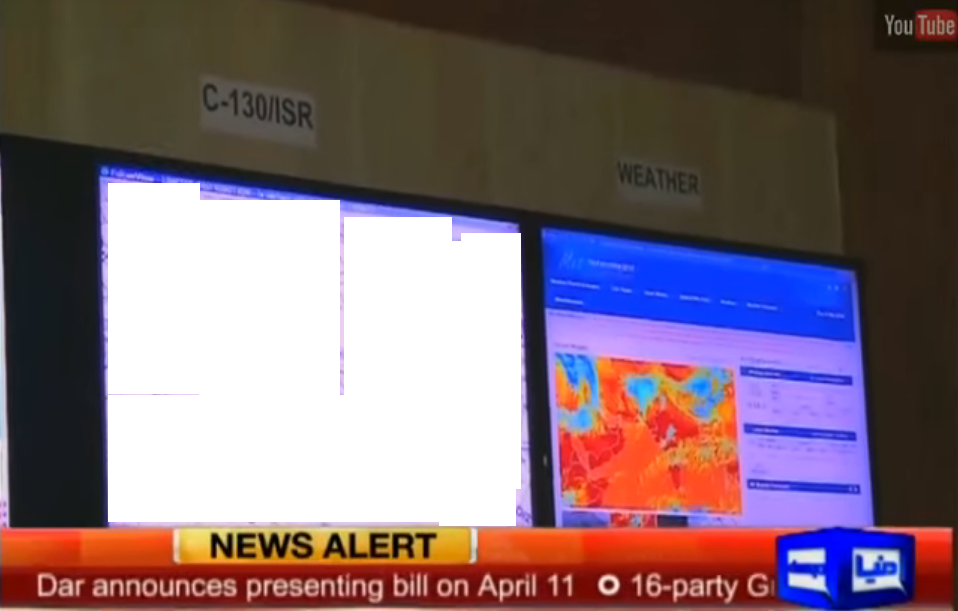

We have seen C-130 capable of ISR integrated with PAF ground station for live feeds in Wajah Saeed TV program from 2016
relevant part from 30:38 onward
(NOTE: it was covering the training center of CCS)
