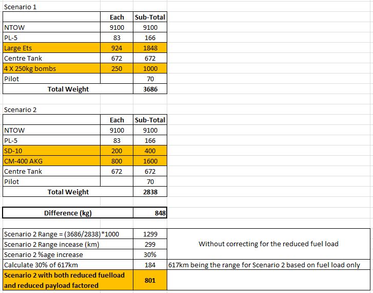

From the Dubai 2011 presentations below:
Internal fuel = (2,300/0.84) = 2,738l.
External fuel = 3,000l.
Total fuel = 5,738l.
Now, this will give 1,000km range in an A2G configuration.
If you loose both the 1,100l tanks, you get rid of 1,848kg, and add 1,600kg from the two missiles. You end up 248kg lighter.
You loose the 4 x 250kg bombs = 1,000kg. You add the 2 x 200kg SD-10s. This is 600kg lighter.
In total you are now 848kg lighter.
Back to the fuel: 5,738l = 1,000km radius.
2,200l less 5,738l means 3,538l = ((3,538/5,738)*1000km) = 617km with CM-400 AKG
I have ignored the weight differences and focused on fuel.
I have gone back to this discussion and researched a bit more on the weight differences and made an attempt to factor in the 848kg weight difference. I have looked around and the aircraft ranges are linear dependent on weight and/or fuel. That makes estimating somewhat easier. Example here:
I am estimating therefore that with the CM-400AKG, the FC-1 will have a combat radius of 801km.
What makes you assume that 30% decrease in load will give you 30% increase in range?
The decrease in load is 23%. The decrease in range would be the same percentage if the graph was at 45 degrees.
The 23% decrease in payload, I calculated to give 30% increase in range.
The question was, what makes you think the relation between payload and range is a linear function.
I have posted a Boeing graph as given by Boeing themselves. If you Google for "Aircraft Range vs payload", and select images you will get dozens graphs of graphs AND THEY ARE LINEAR.
Not an expert in this field but there are three variables to the equation Load, Range & Speed (time), linearity in weight and range would only be valid at a constant speed, if there is a change in speed due to any reason, range may be significantly affected.
I think the relationship remains linear but the slope of the graph changes. I assume at lower altitude or sub-optimal speed, the graph get steeper, making the range shorter.
Similarly, in the Dubai presentations, they even give you the assumed flight profiles.
More fuel is consumed during takeoff, which also varies with climb rate.
Can you say about how much % is consumed of max loaded JFT, while takeoff?
I guesstimate it to be varying between 10% to 30% from low to highest possible climb rate.... considering max load takeoff.
